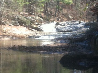

    We are building in a park called Cochran Mill in Chatt Hills (Palmetto, GA) just 15 minutes from the Atlanta Airport. Due to scenery, maybe the best in the state for a bike trail, and easy access to Atlanta the trail has the potential to be one of the top destinations in the state.
    I wish we had someone more experienced than we are helping us build.
    http://www.pillowflex.com/MTBR/HM1.jpg
    http://www.pillowflex.com/MTBR/HM2.jpg
    One of several waterfalls in Park, but the only one the new trail will pass.

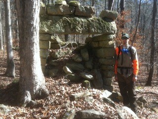

    http://www.pillowflex.com/MTBR/HM3.jpg
    One of dozens of ruins in the park and along the trail.
