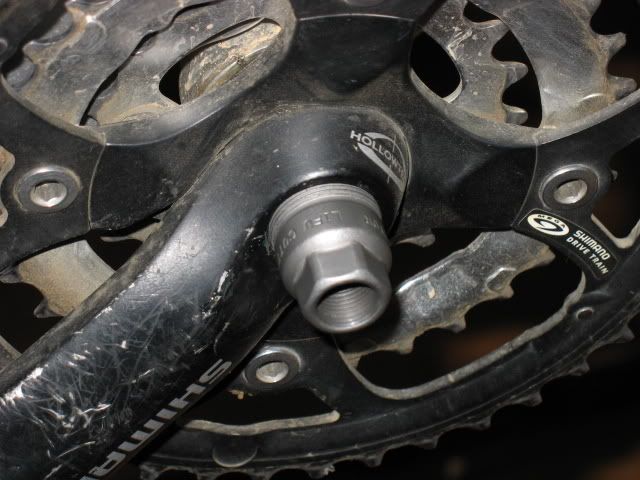

    A few weeks ago I bought a Race Face Evolve DH crank (the one with the ISIS BB) to replace my Shimano Deore M510 cranks. I was told that the cotterless crank extractor that I was using for my Shimano cranks would work with the Race Face, but now that the Race Face cranks arrived I realized that the part of the extractor that threads into the Shimano crank arms does not thread into the Race Face cranks... so what is the correct tool for this application? Mind you thins is my first ISIS bottom bracket, I've been using Shimano's Octalink until now. According to the Park tools website the same tool hould work for both cranlks, but mine doesn't...
    Here's the piece firmly threaded into the M510 crank arm
    Here it is over the Race Face, it won't even start one thread

    You're probably missing the self extracting bolts. or did you nto install them? What does your left side crank arm look like.

    Looks the same, and the bottom bracket that came with the cranks (not Race Face) had regular bolts.

    were the deore's square taper? If so you need a different extractor. The park-tool i use works fine.(ccp-4) Does the tool fit in the non drive side?

    No, the Deore was Octalink. Do all Race Face use self extracting bolts? Because these cranks came with none.

    strange, its possible could be your threads are boogered in the crank / extractor. does it work in the non drive side arm? If not i suspect you might need the self extracting bolts

    Threads are new on both sides, and the threads on the extractor work perfectly on the Deore cranks. It's just a different thread size altogether.

    Ok, are the threads on self extracting bolts the same as regular crank bolts? If they are then I have a problem with my cranks, if they are not then I will order me a pair of self extracting bolts.

    i can't speak for those specific raceface's but all the ISIS cranks I have (truvativ's & race face prodigy)) work fine with the park extractor (CCP-4)

    I just put on a set of Rf evolve Dh cranks on my bike as well, and it also didnt have any bolts.
    I used the bolts from my octalink cranks and they worked fine.
    My crank arm puller also threaded in fine as well.
    try your octalink bolt if it threads in then your puller should work. try it on both arms. if it works on one and not the other, then the threads are buggered on the one arm.

    Well, the Octalink bolts work for the simple reason that they thread into the bottom bracket, not into the cranks arms... the crank extractor tool (mine is a Lifu, looks and works like a Park Tool CWP-6) threads into the crank arms, a different thread altogether. I am ordering some self extracting bolts and hope they work... The cranks are now installed and they work great, they flex a lot less than the Deore (I weight 205 lbs); I just hope I can work a tool to remove them when needed...
