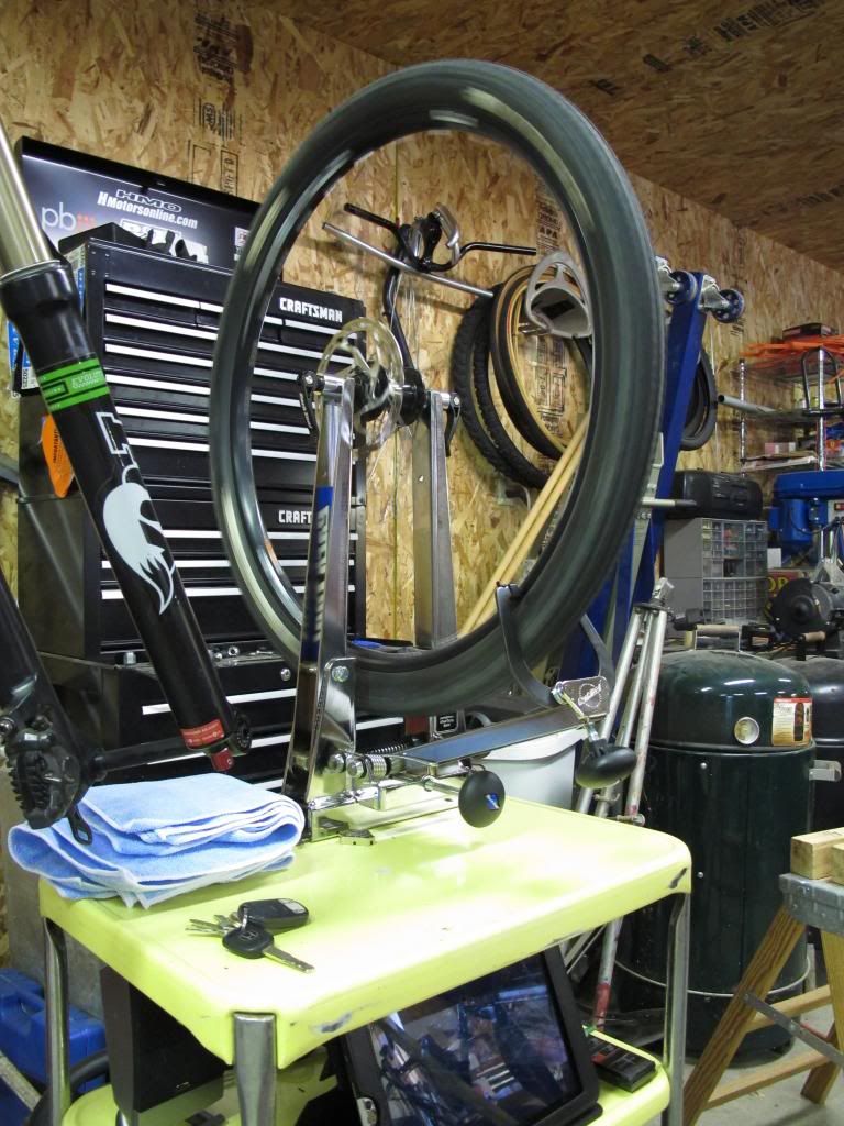

    Fed Ex just dropped off a new Park TS-2.2 at my house this AM. I have been using a borrowed TS-2 and I must say that I am impressed with the improvements over TS-2. First off, it does not need the extensions to true 29er rims with the tire on. The calipers seem to be larger to go around bigger tires and they provided plastic covers for the calipers to keep them from marring the rims. In the bling dept., it has a snazzy plate with the model # and the knobs have been updated. It did however require adjustment. I would recommend buying the alignment fixture with the stand if you do not have access to one.
    Here are a couple pics.
    2,211
    You don't really need the alignment fixture--just get the indicator arm all the way up between the uprights and set it like that.
    Nice looking shop, btw
