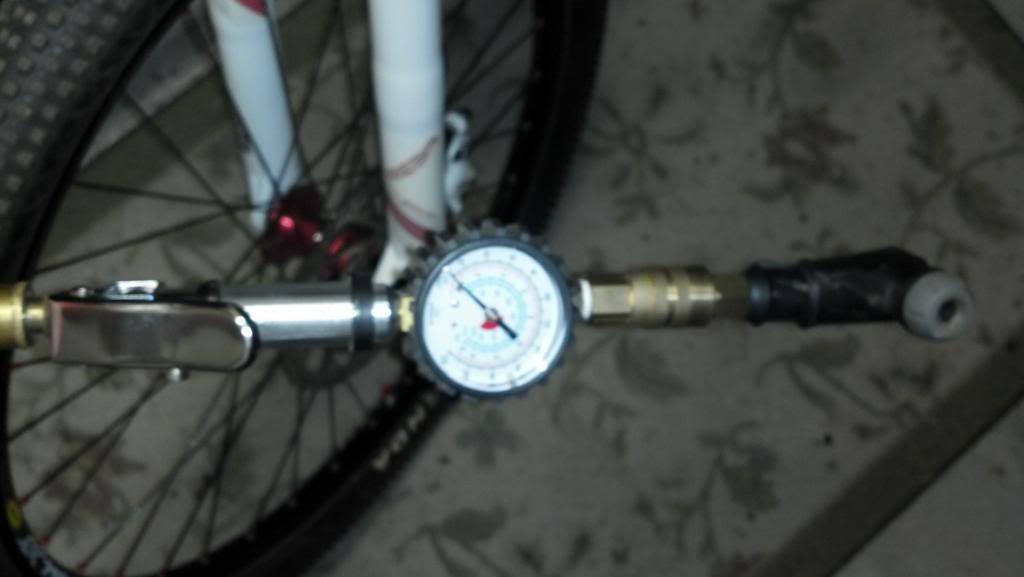

    We've used this in the shop for quite some time.
    However you can buy just the head for about $8 and make your own. I bought one of these Dual Chuck Tire Inflator with Dial Gauge from Habor Freight for $8 and modified it by taking the rubber hose off and putting the metal tube in its place. I then pulled the chuck head off and put on the Problem Solver head. So for over 2 years I've been using my $16 set up without issue.

    Do you have a photo of yours? I was actually just looking at the harbor freight tool just recently. Does yours work with presta valves?

    The Problem Solvers head will do both presta and schrader valves. I rigged mine to be quick release because I use this with a regular air chuck for my cars but originally I had the head directly mounted to the metal tube.

    $10 for this
    Cut off the schrader chuck and add this for $16.
    You can pick up the inflator at any hardware store, but will most likely have to get the silca chuck shipped to you. So for not even $35 after shipping you've got yourself a solid, regulated-flow presta chuck with a gauge. That's half the price of the Problem Solver's Air-Bob, which is half of what Park's inflator costs.

    'squatch et al, good stuff here. I'm going to get me a little DIY project started shortly.
    The silca head is a great idea. My current pump tends to bend the presta screw when the lever is lifted. Then, I would like to add a quick release fitting to have a regular schrader valve available for use with the gauge too.
