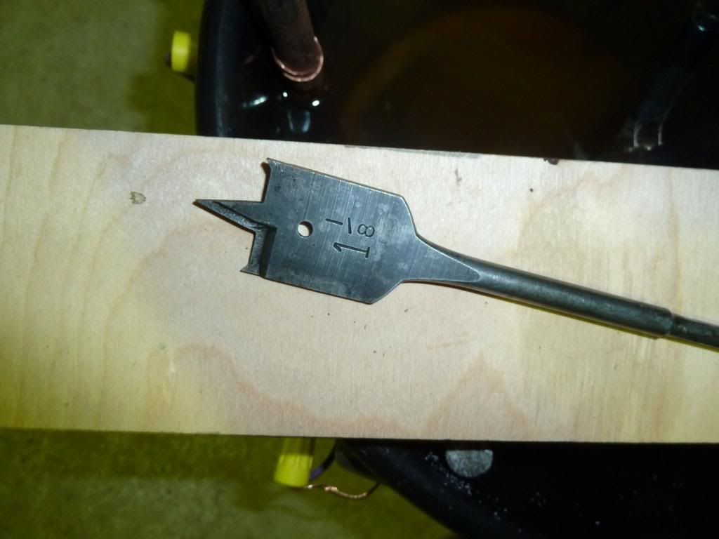

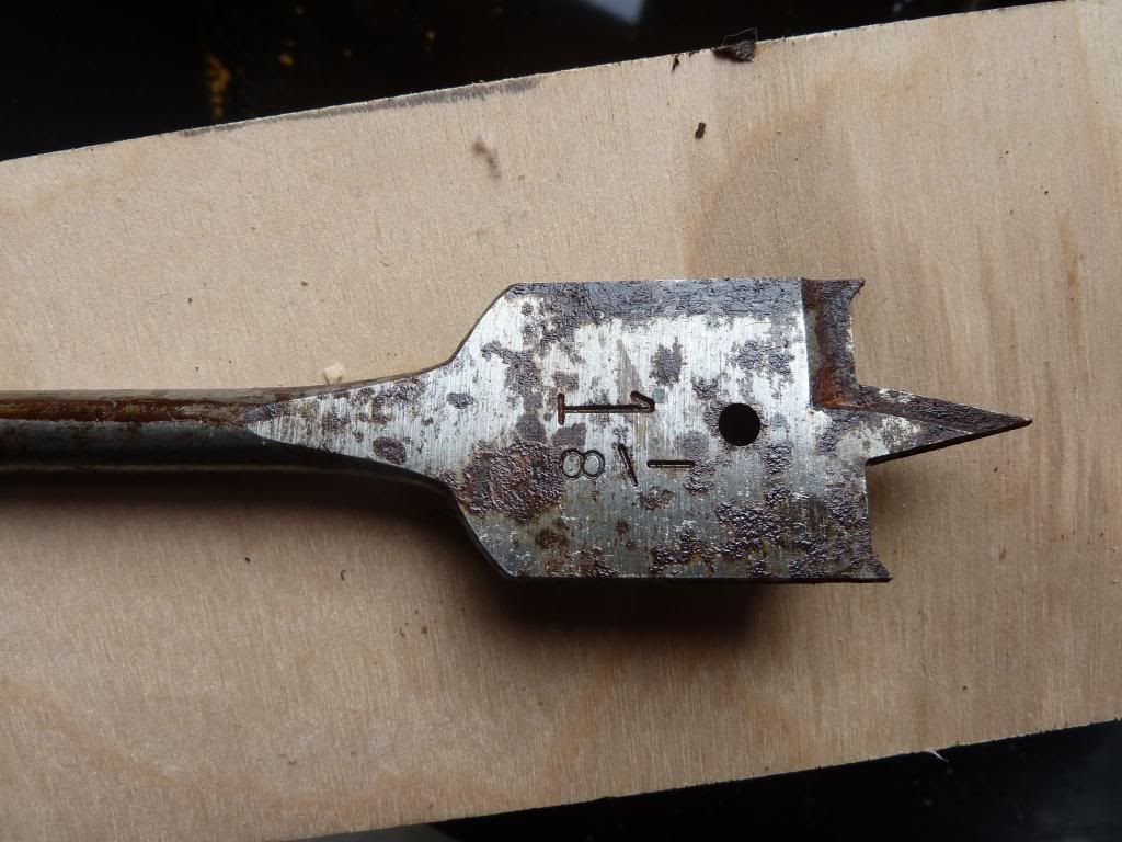

    Thanks for all the tips. I have gone through and wiped all my tools down with oil.
    I did try ELECTROLYTIC RUST REMOVAL as suggested above. It did work, and it is fun, but at ~5 hours per tool its going to take a while. Here is a before and after of a drill blade I did as a test before subjecting any of my bike tools to it;
    Before Electrolytic Rust Removal;
    After;
    Process described here; Electrolytic Rust Removal aka Magic

    1,255
    It's a neat trick to fix rusty things, and definitely the way to go to preserve the tool itself. Grinding or using steel wool can change the tolerances of fine tools, especially wrenches.
