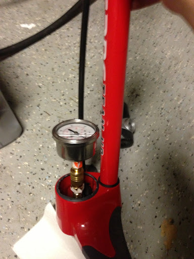

    I have a performance bike Spin Doctor Team HP floor pump that I picked up when it was on sale for like 20 or 30 bucks I think. It has a universal head that suppossedly adjusts for both Presta and Schrader valves but I rarely use it for Schrader valve.
    A while back the needle on the gauge fell off while the pump was knocking around in my car. I disassembled the gauge and put the needle back put the gauge never read right after I did that. It was somewhat annoying but the gauge wasn't that useful anyway even when it did work since it reads up to 260 psi but I never pump my MTB tires past 30 psi unless I'm trying to seat a tubeless tire.
    Anyway, after reading this thread, I had the idea that I should change the gauge to something that has a lower range and is more accurate so this is what I did today:
    I bought a Reed AHNC 0-100 psi gauge from amazon for 20 bucks. The original plan was to just swap out the broken gauge with this new one but the original gauge had a 1/8 connection while the new gauge is 1/4(and I couldn't find anything online that had a 2-1/2 inch gauge with 1/8 connection).
    After I saw the new gauge I started thinking maybe I should have gotten the 0-60 psi gauge instead but the problem is I have an occasional need to pump tires up to 70-80 psi and with the 0-60 psi gauge I wouldn't be able to do that. So then I thought what if I just put a quick connect on there and that way I can swap out the gauges quickly if I need to. So, the above was the result.
    So far I only have the 0-100 psi gauge, the 0-60 is on order but I checked the gauge against my schwalbe digital gauge and for psi over 30 its like less than 1psi difference while under 30 psi I get maybe 1-2 psi difference. I'm hoping the 0-60 gauge will be more accurate under 30 psi.
    Replacing the gauge was pretty easy, just un-do 3 bolts on the bottom of the pump and then unscrew the air hose and remove gauge with wrench and install adapters and quick connect and done.
    It doesn't look pretty but I figure with the quick connect when I put my pump in the car I can remove the gauge and put it some where safer.
