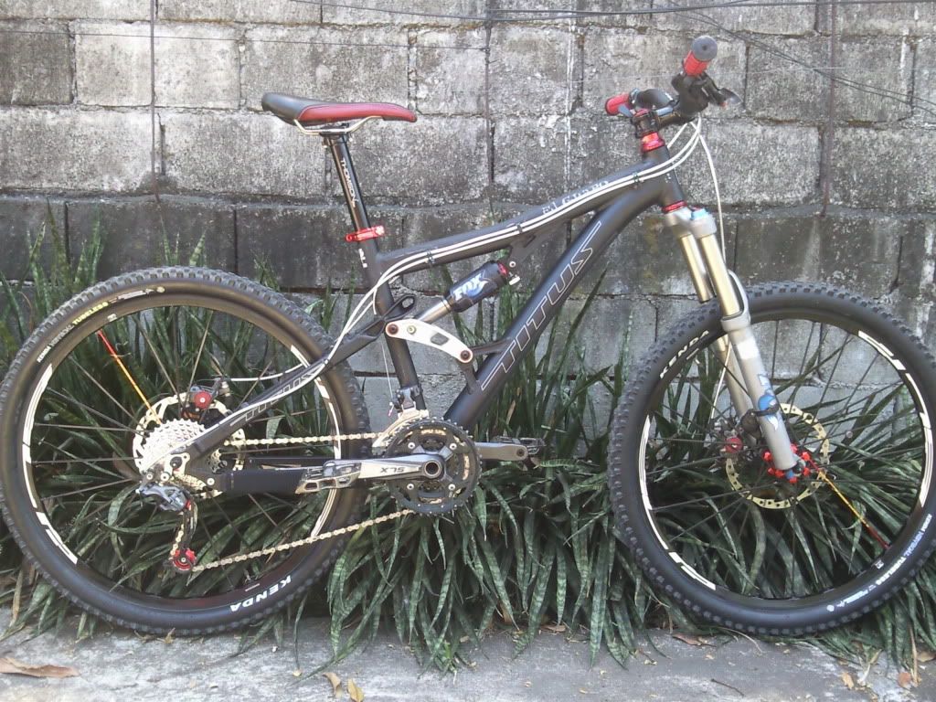

    I'm monitoring low BB thread...but still love my EG...
    Keep maintain at optimum setting, we'll catch the best ride
    Uploaded with ImageShack.us
    Frame / Shock: 2012 Titus El Guapo V3 Small / RS Monarch RT3
    Fork / Headset: RS Lyrik RC2L Dual Pos Air 160-130 mm / Cane Creek 1.5"
    Rims / Hubs: Ethirteen TRS Wheelset(20mm F, 10mm QR)
    Handlebars / Stem: Answer Protaper 720 / Sunline AM 70 mm
    Saddle / Seatpost: Spez Henge / KS i950
    Brakes / Rotors: Shimano SLX Icetech
    Cranks / Bashguard: Shimano SLX / Truvativ
    Groupset : Shimano SLX 2x10, with Clutch RD (Shadow Plus)
    Pedals: Shimano Saint
    Tires: Continental Trail King 2.2

    39
    Aoio that looks epic! What is the cockpit like with that stem and bar?
  95. #295
    Jan 2013
    13
    loved it! It is a little small and some times it feels like you are going to superman over your bars and down the trail but a few rides and you get used to it!!

  97. #297
    Jan 2013
    13
    once el guapo allways el guapo!
  98. #298
    Jan 2013
    13
    That going over the bars feeling was due to the wrong attack position I had in the trails. With a little more bent elbows and lower waist feels silk smooth.
