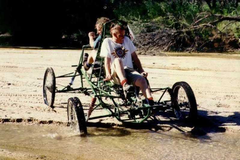

    so a little more news it was a custom build, here in Tucson AZ
    It was known as the grasshopper it had 12" of wheel travel a corner.
    each rider had there own Mt bike 18 speed trans and the rig had a hi and low shift for all input
    It was stolen from the down town Tucson ... years ago.

    I don't know what it is, but it sure looks *****in'.
    I'm assuming there's a transfer case for the rear passenger (stoker)? Wild. And the dorifto is awesome.

    The stoker has a "8" in the chain then that persons input was combined with the front persons. The combined out put went to the #40 chain driving the rear differential.
    You made me look up the word dorifto, guess it fits. On pavement with two strong riders one could push it hard enough to lift the inside front tire off the road.
    It was also good at flying off jumps and loading dock drops.
