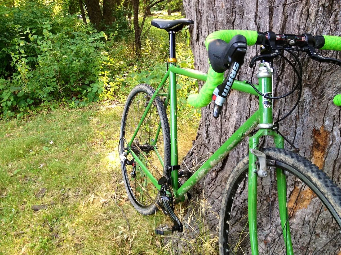

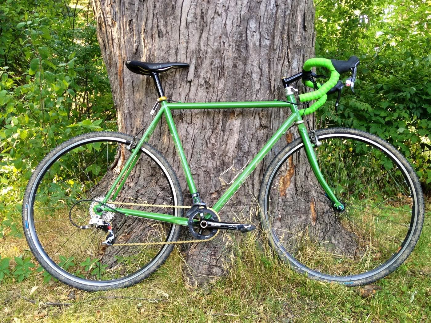

    Ooh, do you have the first generation threaded headset cross check? Could you post a picture or a link to one? Thanks!
  • 01-10-2013
    Ilikemtb999
    It was a navy blue but the paint was falling off so I had it powder coated last winter.
  • 01-10-2013
    ecodoug
    Very nice. I thought I saw a navy blue CC a few years ago in Syracuse, but they were going the other way and I didn't get a good look at it.
