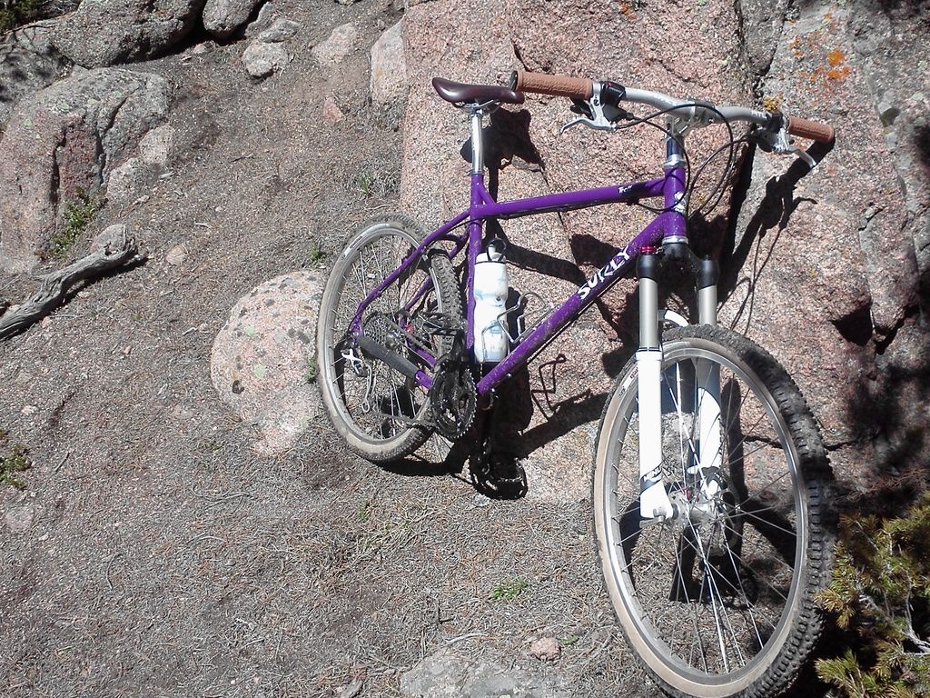

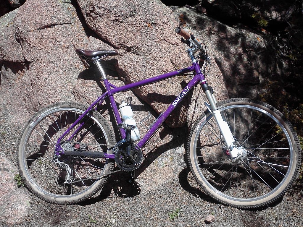

    Here's my newly built Troll on her first real outting of the season in Medicine Bow Nat'l Forest this last weekend.
    The parts build for those who care:
    Frame: Large Eggplant Surly Troll
    Fork: Manitou Minute Expert
    Headset: FSA Orbit MX
    Crankset/BB: E*thirteen by Hive XCX+
    Rear Der: Shimano XT
    Front Der: Shimano XT
    Shifters: 3x9 Shimano XTR 970
    Stem: Thompson X4 80mm
    Seatpost: Thompson Setback
    Handlebars: Raceface Atlas
    Grips: Easton 33mm
    Pedals: DMR V8
    Brake Levers: Paul's Love Levers
    Brakes: Avid BB7 w/Jagwire compressionless housing
    Wheelset: Rhynolite rims on Shimano XT hubs
    Cassette: Shimano XT
    Tires: Charge Splashback Tanwall 26x1.8
    Saddle: Chromag Trailmaster LTD Leather
    And that's that. She's finished except ill be building a tubeless wheelset soon to swap when trailriding. Schwalbe Hans Dampf mounted to Stans/DT Swiss 350 rear and Stans/Hope Pro Evo 2 Front.

    Okay, I'm still waiting on some parts. I heard the Troll can take a variety of wheel sizes, but I guess there are limits. :-)

    I gutted my poor LHT and raided my parts bin just to get this thing on the street (which I still haven't done yet because it's kind of late for a test drive), but until I get my hands on the parts I want, I guess it'll look like this.

    Quote Originally Posted by Rob_E View Post
    Looks good and that's a great color!! Are you going with silver or black components?
  49. #1549
    Reputation: Rob_E's Avatar
    297
    Quote Originally Posted by corwin1968 View Post
    The plan is black, although right now it's all parts from my mostly-silver, touring bike. It should shift as I get more parts for the bike.
