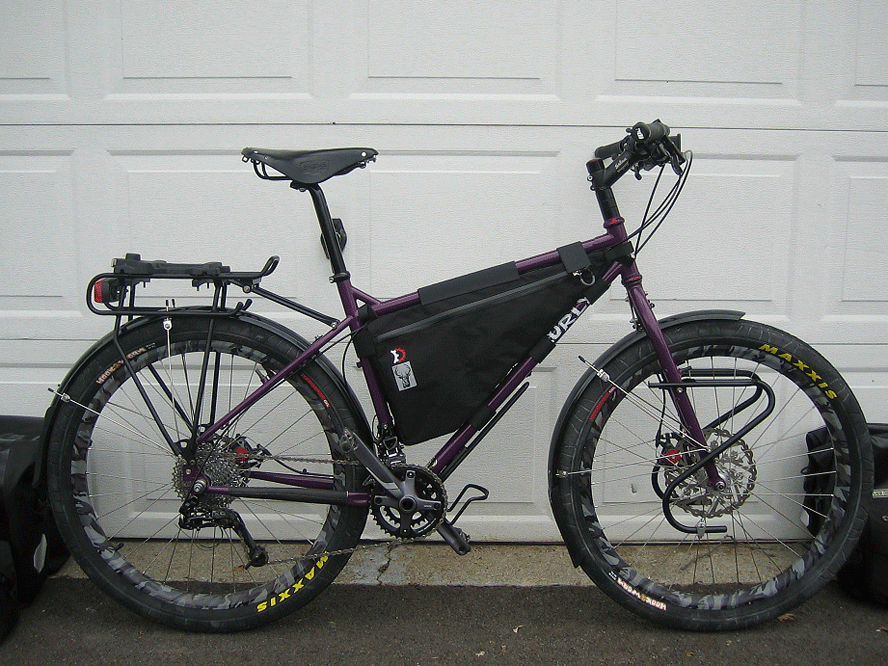

    Quote Originally Posted by Gritter View Post
    My Troll was built up as a "Tractor Bike" and it's used to haul most anything, anywhere. I have it geared really low, with huge brakes, for that reason. Sorry about the crappy pics, I should probably snap a few outside, in the sun.
    I don't usually haul the entire ensemble of bags, but that's what it looks like in full-hauler-mode, plus I have the TED Trailer to pull behind all that as well.
    Coming from the single-wheeled B.O.B. Trailer, I LOVE the TED. No more balancing all the trailer weight, making my bike squirly with heavier loads. The TED seems wide, but it's narrower than my handlebars, and saddlebags, and fits wherever I point it.
    (NOTE: The Tubus Duo Racks up front cleared just fine with the 203mm Avid Caliper Adapter - just moves it away enough to clear everything.)
    I also tried the trailer on the Ogre, but the Troll feels "tighter" all around, and I prefer it for hauling heavy loads. It might have something to do with the smaller diameter of the wheels, but it's also the geometry of the frame, making the ride stiffer, but still compliant. I find this configuration superb for my "cargo" bike.
    Nice build! Your bike is looking sharp. I've seen those rims on a couple bikes now and always like the way they look. I Pull my bill trailer with my troll, I have not yet tried pulling it with my Karate Monkey but I bet I would agree with you on the tighter feel of the troll. I also use the surly skewer and not the bill nuts in the special holes above the axle because I like to keep the yoke as low as possible.
    Everything except the frame bag is quick-release.
    Gritter, fantastic build and has caused some rack envy. Question on trunk bag attachment, which attachment adapter did you order with your trunk bag? Looks like the Ortlieb. Thanks in advance. I will be ordering the logo evo rack.

    Quote Originally Posted by Lone Desert Walker View Post
    My troll is kind of unique because Surly screwed up and painted an ogre fork purple and shipped my bike with it. So I guess I have a Trollgre. I first noticed because of the position of the brake posts. I got surly to send me the right fork but it turns out that that bike handles better with the 29er version so I am just going to keep it on there. I wonder how many other people have an ogre fork on their Troll? I took the front wheel off my Monkey and threw it in there 69er style and it rode ok. I could still no hands it on the pavement so the geometry didnt get stupid but was definitely feeling slack! I am going to try it on the trail like that one of these days.
    Thanks, Lone Desert Walker. That's the first wheelset I ever laced, and they turned out better than anything I've ever had. The wheels are the first thing most people notice, and everyone asks me where I got them. I love saying, "I built them."
    I'm glad you got that fork thing worked out, but that's crazy that you prefer the "Ogre-Length" fork. I guess you got the right bike and fork for you to begin with! I filled my "trailer-nut" holes with little hex-head plugs (expensive: Universal Cycles -- Problem Solvers Derailleur Hanger Plug) and it's a clean install. I have the trailer nuts for my Ogre though.
    What are you going to do with the proper (453mm A2C) fork now? 468mm seems like quite a big jump in slackening your head angle. Is it a more comfortable reach to the bars, or do you actually like the "chopper" steering feel?
    Quote Originally Posted by Meat Foot View Post
    Meat Foot, it is the Ortlieb adapter / locking-plate for the rear Trunk-Bag. It weighs a TON though. It's secure, and the bag attaches to it, almost identically to my motorcycle's GIVI luggage, so that's what sold me. The lock portion must be the culprit to its immense weight. I sometimes wonder what life would be like if I got the RackTime mount - since I have the RackTime racks already, less secure, but lighter and I wouldn't have to keep track of a key. The Ortlieb mounting plate does come with "arms" that allow for lower pannier mounting, so you can use both the trunk and panniers, but my RackTime Racks already have the lower "arms" so I didn't need to use that function. I also think the R.T. plate is cheaper - because it's like forty dollars to buy another Ortlieb plate so I can quickly use the same trunk bag on two different bikes. I hope that helps you decide which one to choose. I love the ORT Plate though, I just wish it was keyed the same as my Ortlieb handlebar (also locking - same lock) bag.
    I chose the ORT Plate, because there are no moving parts on the bag part, and it seems the most heavy-duty of the three.
    The Ortlieb plate also makes the trunk-bag angled up towards the rear, to account for the lock. I don't mind, but I think the R.T. plate makes the bag sit flat on the rack. There is also a third plate, compatible with the R&K mounting system as well, but I know nothing about that one.
    @ Gritter -- Thank you for the write up. I was able to save a little $$ and order the Racktime Addit rear rack, so thanks! I also ordered the Ortlieb Ultimate 6 Plus h-bar bag, do you (or anyone else for that matter) think it will play well with a small blinky and the Surly Open Bar, zero rise? I have that bar (well actually my shop has it in my bin while I wait for the frame to come). Also, reading other folks impression of the Ergons, while they are a great grip (and I was sold when I saw their contoury-ness, I know not a word but it fit) the ESI super chunky grips may work better with a more radical sweep like the Marys and Open Bars. Am I overthinking this? I hate do overs and "gee wish I had waited 6 more nanoseconds".
    Meat
    Meat, let me know what you think of that rack. I returned a Tubus Cosmo for the Racktime and it's been holding up great and I love the design.
    I have "alt bars" on my Troll, though not as extreme bends as the Open Bar, but the bag fits nicely between the curves. It should work well with your bars, because it sticks out a few inches. My "Ultimate 5" handlebar bag blocks any light I had on my bars, so I'm still trying to figure out how I'll mount my light to the fork, I guess. If it's just a small blinky, you might get away with attaching it to your bag somehow, I don't know.
    From what I've read, people prefer the chunky grips for swept back bars, and ergons for traditional straighter bars. I plan on picking some up to try out.
