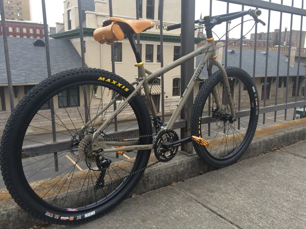

    Velocity Cliffhanger Rim 25mm internal width. Makes the tire very chunky. Maxxis Ikon 2.35 and its tight. No rubbing only at extreme PSI lows.
