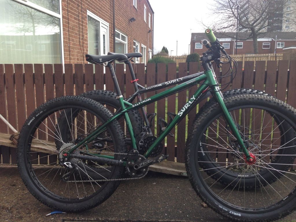

    Reputation: saltyman's Avatar
    1,376
    I'm 6ft and 32" inside leg....medium krampus is a perfect fit.
    780mm crank brothers bars
    400mm crank brothers post
    Hope hubs
    Zee crank
    Slx mech and shifter 10 speed
    Nukeproof electron pedals
    Wtb saddle
    ESI chunky grips
    Gusset stem and brakes 180/160
    Larger than my Fargo wheel
    Moonlander angles
    2014 milage so far - 2,485
    www.ukfatbikes.co.uk

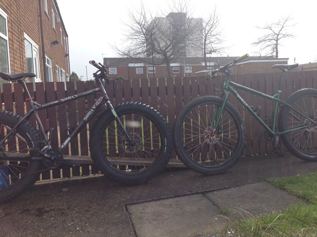

    OK, for the uneducated Saltman, give us a run down on the Moonlander - what rims and tyres are those? I just sat and stared at this pic with my jaw dropped, those tyres on the Moonlander look GiNormous Have you, or could you weigh the rear wheels on both of those bikes, curious what sort of weight difference there is in going semi-fat with the Knard as opposed to going full fat?
    Quote Originally Posted by saltyman View Post
    Geordie biker
    1,376
    Moonlander is still on standard clownshoe 100mm rims and has the 4.8" bud and lou tires.
    No idea what the wheels weigh on either bikes, never been fussed in weight, traction without compromise is what I went for!.....they certainly grip....and turn heads, that's for sure.
    People comment on my krampus tires, saying there huge.....but when they see the fatbike they are stunned.

    90mm stem working fine so far.
    Centre of crank to seat rails is 27.5" in my normal riding position.....maybe lower it an inch or two less if I'm offroading.
    First look.....I thought I had messed up going smaller than the moonlander.....but it's awesome.
    I know the odd time I'm rock crawling, the moonlander can be a handful and not as nimble as I'd like, but 95% of the time it's perfect.....so going to a taller wheel I wanted more crotch space as the krampus is my play bike.

    <a href="http://www.flickr.com/photos/33936975@N00/8440210936/" title="Krampus 01 by normbilt, on Flickr"><img src="http://farm9.staticflickr.com/8229/8440210936_9b023a349a.jpg" width="500" height="375" alt="Krampus 01"></a>
    <a href="http://www.flickr.com/photos/33936975@N00/8440210540/" title="Krampus 02 by normbilt, on Flickr"><img src="http://farm9.staticflickr.com/8463/8440210540_15f31e7f64.jpg" width="500" height="375" alt="Krampus 02"></a>
    <a href="http://www.flickr.com/photos/33936975@N00/8441652871/" title="Krampus Inaugural Ride by normbilt, on Flickr"><img src="http://farm9.staticflickr.com/8088/8441652871_b60f417208.jpg" width="500" height="375" alt="Krampus Inaugural Ride"></a>
    <a href="http://www.flickr.com/photos/33936975@N00/8441652089/" title="Krampus Inaugural Ride by normbilt, on Flickr"><img src="http://farm9.staticflickr.com/8080/8441652089_74404f9878.jpg" width="500" height="375" alt="Krampus Inaugural Ride"></a>
    <a href="http://www.flickr.com/photos/33936975@N00/8442749032/" title="Krampus Inaugural Ride by normbilt, on Flickr"><img src="http://farm9.staticflickr.com/8476/8442749032_2df65dd271.jpg" width="500" height="375" alt="Krampus Inaugural Ride"></a>
    <a href="http://www.flickr.com/photos/33936975@N00/8441659385/" title="Krampus Inaugural Ride by normbilt, on Flickr"><img src="http://farm9.staticflickr.com/8089/8441659385_f7ddb0166a.jpg" width="500" height="375" alt="Krampus Inaugural Ride"></a>
    Parts Spec For Krampus
    Frame Small
    Headset Cane Creek 110 ZC Top EC Bottom
    Crankset Race Face Turbine LP
    BB. Race Face Ti ISIS 113 Spindle
    SRAM XO Short Cage Rear Derailleur
    SRAM XO Shifter
    SRAM Hollow Pin Chain
    Cassette SRAM 990 Red 12-32
    Brakes AVID BB7
    Wheelset
    Hope Hubs/Wheelsmith DB Spokes Rabbit Hole Rims
    Knard 120 tpi Folding Tires
    Kenda 700x45 Tubes
    DUCK Chrome Duct Tape Rim Strip
    Seatpost Thompson Elite 27.2 Setback
    Stem RACE FACE Cadence 100mm
    H-BAR RACE FACE TURBINE cut down to 26"
    Saddle Selle Italia SLR 180Gms
  92. #92
    129
    normbilt,
    nice bike!
