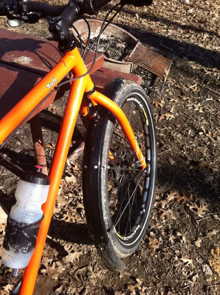

    60
    Here's mine.
    I used two pieces of metal for a little extra strength. Also added an extra set of stays to the fender to make it a little more stable. The wider tires would make contact with the fender over larger bumps. Basically converted the Hardcore fenders to Cascadias with the the extra stays and mudflap.
