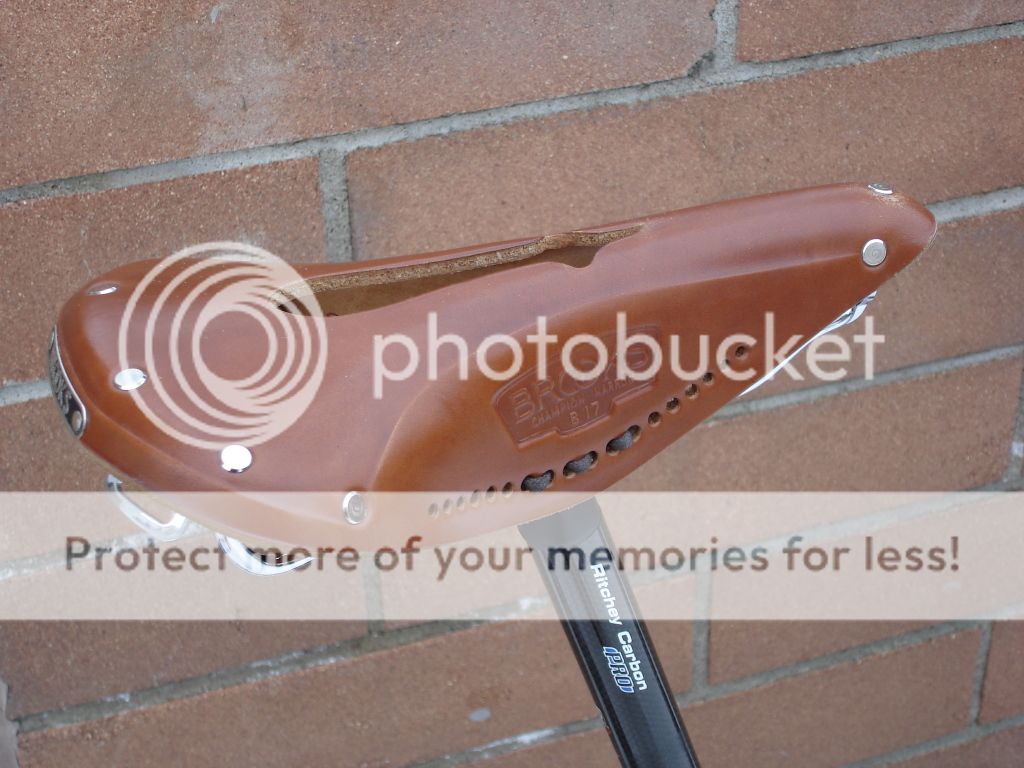

    Really?, I'm starting to think that putting an aluminum post on any steel frame is retrograde. People choose steel and carbon over aluminum for it's ride quality for frame material and then take a step backwards and by using aluminum seatpost. My KM with a Ritchey Carbon Pro and Brooks B-17 Imperial Narrow was awesomeness.
