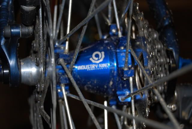

    233

    I don't race, and thae chances of racing are slim to none. This is $750 well spent IMHO.

    How do you like the I-9's? I'm wanting to build up a set for the SS. Thats one of the few I haven't owned, but man, do they look good. I have buddies that swear by them.

    233
    Quote Originally Posted by oldskoolm4
    They are tremendous. Light and stiff. I am especially impressed withe the stiffness. Seem to be tough too. Highly recommend.
