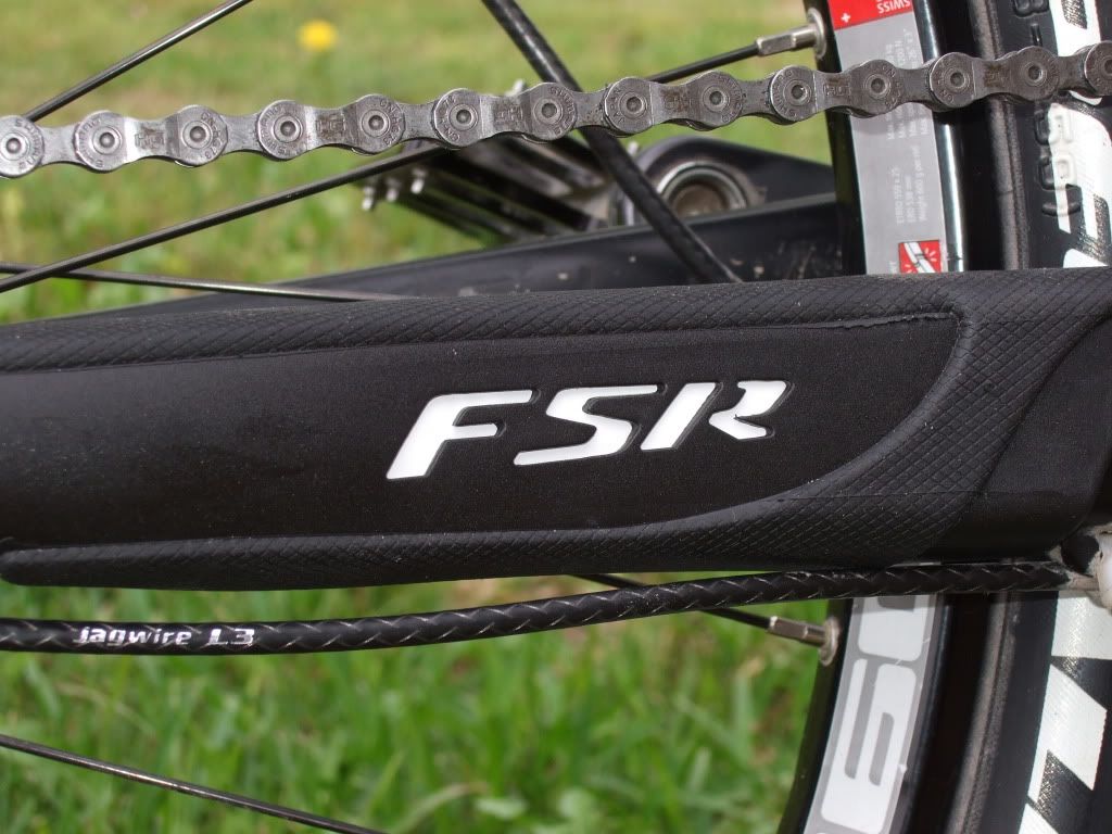

    Removed chainstay protector and replaced with 3M tape to drop 50g
    New chain time, replaced aging SRAM 10 speed with KMC 10SL which suprisingly weighed 2g more for the same length.
    Got a new stem to try, a shorter 35mm length. Comes with steel bolts standard so will drop 10g with Ti bolts.
    and titanium bolts
    and for comparison purposes.....
