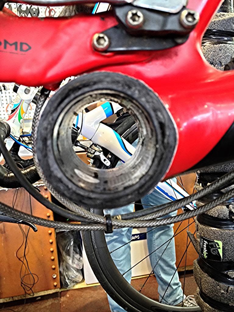

    Reputation: beshannon's Avatar
    Oct 2012
    249
    Quote Originally Posted by beshannon View Post
    My Epic Comp Carbon 26" is almost a year old and I have had no issues at all other than normal maintenance.
    I have ridden about 1600 miles in the last year and am pleased with the bike.
    No issues with my shocks or brain but I am now waiting for a warranty replacement decision after the carbon began to separate in my bottom bracket, about 2100 miles
    Not happy

    Reputation: phlegm's Avatar
    3,753
    Not happy
    Wow, sorry to hear this!
    If you look at the empty frame around the BB area (similar to your photo, but pre-destruction), you'll notice a nicely-finished carbon "cylinder" that the crank & BB assy slide into. It includes the serial number printed in this area as well. You can see that it is a separate piece somehow integrated into the rest of the carbon frame, and I wondered how it was bonded to the rest of the frame.
    Looks like the bond failed in this case.
    Oct 2012
    249
    Quote Originally Posted by phlegm View Post
    That was my LBS view as well. Still waiting to hear, they did not call me yesterday as promised
    Oct 2012
    249
    Update:
    I have been told that Specialized has agreed to uphold their warranty and send a replacement frame. I will update when I have my rebuilt bike back.
    Oct 2012
    249
    Not happy
    Well, this went far better than expected.
    Specialized honored their warranty and gave me a big surprise. After some back and forth with my LBS (thanks Buck) and a tense week of waiting, Specialized sent a brand new S-Works Epic frame.

    Attachment 889009
    Now to see if I can improve my skills to match the bike. Looking forward to getting back into the dirt after three weeks on my road bike!
    Thanks again to Specialized and Spokes ETC in Fairfax, VA!
