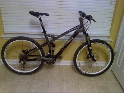

    I'm thinking about upgrading my wheelset on my 2010 Stumpjumper FSR elite. I'm looking for a wheel that is lightweight, durable, and low maintenance. I weigh 210 lbs and ride aggressively (more all mountain than XC). What wheel would be the best choice for the money?
