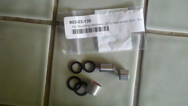

    Well got the problem sorted with the help of Fox, they sent a mounting kit WHICH PERFECTLY FITS for a conversion to a Fox shock.
    TOP MOUNT
    Note they send TWO sets of the top hardware, one for a smaller eyelet and one for a larger eyelet (the standard Fox eyelet size) which is 12mm OD which you install through the press-in bushing. I saw non need to replace the bushing which you see here at the bottom.
    BOTTOM MOUNT
