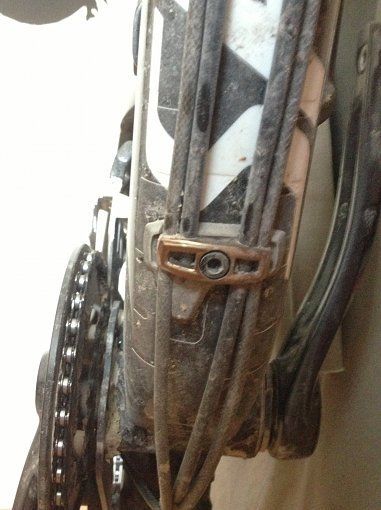

    I have a 2013 Camber EVO 29er that came without a dropper post. It has a setback post 30.9 mm with internal cable routing holes.
    Any reason the IR post won't work for this bike. I would also buy the lever, Do I need to get the seat clamp or use the one I have?
    I converted it to 1x10 so I have the space available for the lever on the left side. Here is a picture. I still have the little adapter for the brake lever. I assume this will work for the drop post lever?
    If the path ahead looks dangerous ------- it probably is!
    Aug 2013
    770
    Command post will work great. It comes with the lever and cable. You don't have to change the seat post clamp, but if you get the post with the external cable, the clamp with the cable guide is nice. I did that for my 2010 Stumpjumper FSR.

    Reputation: MObiker's Avatar
    213
    I am glad you mentioned that, here is a comparable carbon frame bike with the command post. You can see the cable runs through the top tube hole and comes out a hole by the seat tube. Routes up from there to the post. So will a regular command post work for this?
    Specialized Bicycle Components
    Reputation: jimw's Avatar
    525
    Yep, that's the regular Command Post mounted on the bike in that picture, and that will work just fine. It might be possible to route the IR model using that same hole (the link I mentioned above describes how someone did it with a Reverb), but it could be a pain.
