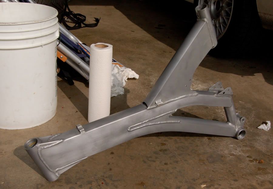

    After driving about 85+ miles roundtrip to go pick the frame up, I got to work stripping the paint right away. Felt kinda bad because the frame had been recently re-painted (hadn't even been built or ridden since the repaint), but oh well...wasn't really a fan of the paint scheme. Anyway, looks as thought the red/black paint scheme was spray canned over the factory powder coat. Using my usual brands of paint stripper, the red/black spray paint came off easy. The powder coat...not so much. Had to step it up to something more caustic to get through the resilient powder coat. Ended up with some Tal Strip II Aircraft stripper. Brushed it on THICK, let it sit for 30-40 minutes, waited for the powder coat to bubble, then scraped off with a plastic scraper and rinsed with water. Repeated this process till it was all gone (kind of a messy PITA!) then gave the complete frame a good rubdown with some Scotchbrite pads. Here's what I ended up with:

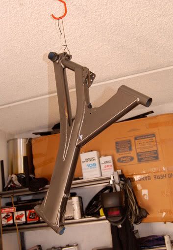

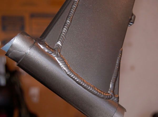

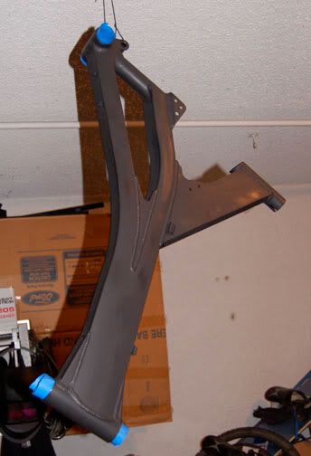

    I decided to just spray paint the frame for now and settled on going with a gunmetal color. I'd really like to get it powdercoated for a more durable finish, but I don't want to spend the $$ right now for it and am kinda anxious to get the bike together so i can ride it.
    Before getting to paint, etc though, I drilled out all of the cable guides since I am going to run full cable housings on all of the cables. After that it was time for paint.

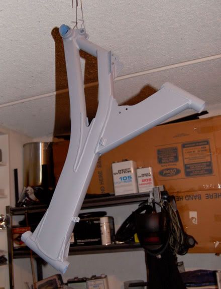

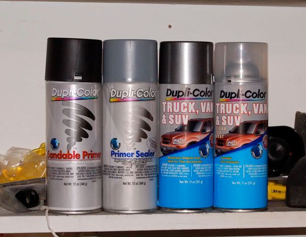

    Here's the cans of primer and paints I used:
    I cleaned up the frame first, blew off any dust, etc and sprayed a few coats of sandable primer:
    After the primer coats were done and dried, I wet sanded any rough spots or imperfections then laid down some primer sealer:
    After the primer sealer was dried, I again wet sanded any imperfections and laid down the color coat. Here's the frame after I sprayed the 3rd coat of color:
    And a closeup of the color itself:
    Next up is some clear coat to add a bit of protection for the paint, but I want a satin or matte finish. Still trying to find a spray can matte or satin clear, but if I can't find one i'm thinking about spraying a regular gloss clear then sanding that with 2000 grit wet/dry sandpaper to achieve the matte look. Anyway, that's all for now. Will update more as work progresses...

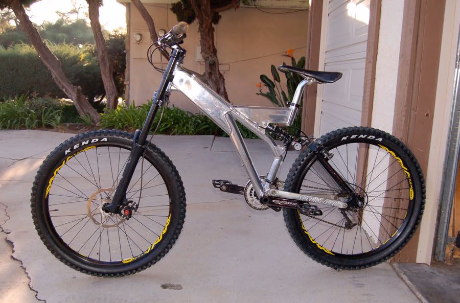

    That's some great insight Rod and answers a lot of the questions I had regarding this frame. Thanks for that. Right after getting the frame from you I started scouring the net for info on the FSR DH and pretty much came up with nothing other than a few old, poor quality pictures. Couldn't find any info as far as specs, etc. and Bikepedia definitely didn't list anything. But then again, bikepedia doesn't list the Palmer special edition of the FSR either so there's definitely stuff out there that hasn't made it into bikepedia.
    Regarding the shock mounting holes, wasn't really sure what the deal was with that because I haven't seen any other max frames that had multiple mounting holes for the shock. It also appeared to me (from pics at least) that the holes were in a slightly different position than those on other max frames. Since I don't have another max frame to compare it to directly, I just chalked it up to perhaps an optical illusion from the pictures, but I guess I was right after all.

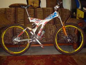

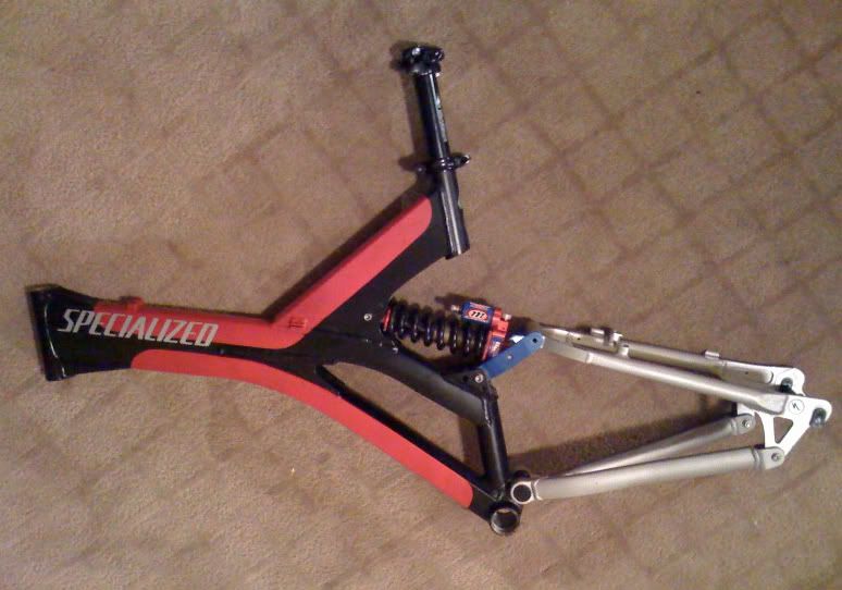

    Anyway, here's the few pics I could find on the web:
    Those 3 are the only ones I could find of an FSR DH. The last pic is what I used to base the artwork for the "DH" decals i'm going to put on my frame.
    Here's a couple of other pics I found interesting as well:
    The first 2 are of the limited edition Palmer bike. One just of the bike, and the other in use by what looks to be a Specialized team rider (based on him being dressed head to toe in Specialized gear) if it's not Palmer himself. The last pic is just one I found, but have no idea what model it is. Never seen one with those decals on it. Anyone know what it is? Looks like it might be a DH since the few pics i've seen of the DH and the Palmer bikes came with that same chain tensioner/bashguard setup. Anyway, thanks again Rod for the added insight. Just trying to find out as much as I can about these bikes so if you have any more info please feel free to share it!
    Oh, and just for comparison sake, here's a pic of the FSR Team DH bike:
    Would love to have one of those, but I don't have much need for an all-out DH bike. I need something I can ride up as well as down on...

    That american flag bike, IIRC was a bike that Palmer rode at the worlds that year. You can usually tell it is one of his bikes, because his independent sponsers were Manitou (so you never see him on a Boxxer outside his eary years) and also Magura, with the bright yellow calipers.
    Does that Manitou rear shock look familiar
    The DH bikes were only available as frame sets, and cost around $1999, which was almost as much as the Elite or Pro FSR at the time. This is one of the reasons I don't think many people bought them. Plus nobody outside of DH guys or freaks like myself wanted a "DH" bike with a crazy 5"+ travel back then.
    Nice job on the "DH" logo, you hit it, you probably had to search hard for that one.
    340
    Quote Originally Posted by rodH
    Ah, that explains the mango colored Manitou front fork and neon yellow calipers on the "Palmer" FSR too. Interesting.
    When I first saw that pic of the rear link on the DH, first thing I noticed was the rear manitou shock. Same as the one that came with my DH frame.
    Also, the fact that the DH was only available as a frameset explains why there isn't much info out there on them. It's funny though...back in the day the DH bikes had 5+" of travel. By todays standards, that barely counts as AM. Anyway, thanks again Rod for the added insight into these frames...
    Oct 2007
    1,544
    Quote Originally Posted by atchipmunk
    Alvin & rod, that 3rd pic you show tells me alot. Only 1 set of shock mount holes and my frame is def. a DH frame. My frame looks identical to that pic. I wonder if a guy could talk directly to Mike Sinyard of Spec. and get the real story about these bikes/frames?

    On a side note...while surfing around, I came across another swingarm/chainstay that was made for these bikes. The Szember swingarm. Dirtworld did a little writeup on it back in 2000: http://www.dirtworld.com/PRODUCTREVI...ory.asp?id=235

    Interesting. It looks like the frame he is using is the Chinese non-MAX frame, which had less beefy chainstays than the MAX. It is unclear if the chaistays added the 6" travel, that would be impossible, so I am assuming it is in combination with the MRP linkage.
    I thought the exact same thing. Don't see how just the chainstay itself could add travel. Must be in accordance with the MRP stuff...

    Alvin, I bought the bike as you see it except it had a downhill seat. I bought the Pro first for my son and thought it was a great ride. I needed a larger frame so kept looking. Found the DH on Craigslist. Pic attached with the DH seat. I'll measure and photo whatever might be helpful.
    Name:  FSR DH Craigslist.jpg
