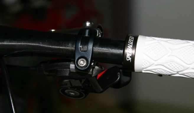

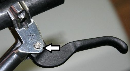

    I got this to work, and as promised here are a few shots to help illustrate it. I'm not sure if it will be comfortable long-term yet though.
    As shown by the arrow, the XTR clamps have a slot and screwhead opening. This is for use with I-Spec shifters, but I'll be using it to mount the XX shifter. You need a thin T25 wrench to fit through the top of the clamp:
    This photo shows the shift lever pin that I was trying to describe in a previous post. As you can see, the outside of the pin is exposed, and when I first secured the XX shifter against the brake assembly it would press on the pin and prevent the brake lever from moving freely:
    The next shot shows the XX shifter clamped to the XTR brake body. The top arrow in this case points to the rubber washer. As mentioned, it allows the brake lever pin to move freely, and also makes for a good surface to mate the two pieces. Keen eyes will also notice that the XX assembly doesn't sit flush/square against the brake body. If you look at the bottom arrow you'll see a slight angle where the two assemblies meet. All I can say is that I can tighten the T25 securely, and the rubber washer keeps things from slipping.
    Finally, here's a shot of the final work, with just one clamp on the bar. I'm not a SRAM guy, so I'm new to the "push-push" shifting. As such, I'm not sure how comfortable it will be:
    Also note that I'm very close to my grips (Specialized Rocca) with shifting - just enough clearance. Thinner foam grips probably would allow you to move the clamp closer to the grip if you wanted.
    I'll report back with more details as I get to test it.
