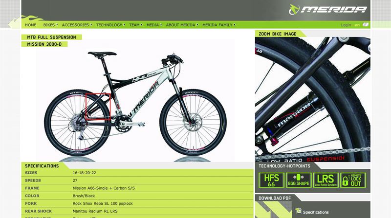

    I guess it's possible to retrofit another rear shock to the Epic. Here's a bike that is similar to it's design.
    Check it out http://www2.merida-bikes.com/en_INT/Bikes.Detail.50
    But like the others said, just sell your Epic or just wait for the AFR to be sold separately. I heard it'll be out this year. Good luck and post some pics if you do decide to change it.
    the centurion I posted above is the same system, centurion is the german distro for merida and they sell under their own name too using the same LRS suspension system

    Crisillo - I kinda figured that it would be the same bike. You think it'll work?

    Quote Originally Posted by ALFRED
    they are similar enough.. but I am not sure if the use the exact same length stroke... because for instance the centurion above has 120mm travel... so it would be good if you could check the specs.
    for example here is one on ebay.de right now (size 320 x 63 mm)
    http://cgi.ebay.de/Manitou-Swinger-A...QQcmdZViewItem

    http://www2.merida-bikes.com/en_INT/Bikes.Detail.49
    27
    Yep, the DT Swiss also products shocks for the merida's LRS system. And you can find them on the market. I've seen them in online stores.
