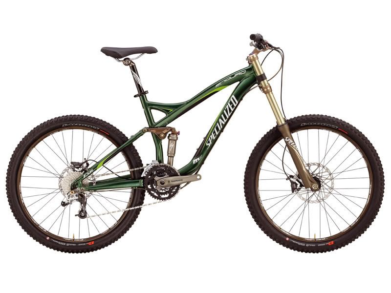

    Like the title states, what size SL or Pitch do you ride and how tall are you?
    I was going to order my new ride this last weekend but I was too unsure on the size so I am holding off until I have a better idea as to what size I should get. I am 5' 10 and have ridden med frames in the past, however I almost feel I should look into a lg but I think the TT is going to be a bit too long for me.
    Thanks for your input

    Hey Guys, thanks for your input I do appreciate it. And I am happy to say that I ordered my new ride today. For the longest time I had been planing on ordering a Pitch but instead I ordered this... in a med
    At least the frame anyways. The frame comes with the front der, seatpost, seat clamp, HS, frame shock, e150 fork w/ the hub. And I have everything else that I am going to need to build 'er up. I am psyched! I should have the frame by next weekend.
    Oh, the green frame is a maybe. My Boss is going to see what he can do to get the green frame for me but right now the Specialized dealer website only has the ti frame availabe in the frame only and the green is only as a complete bike. So green, ti whatever, as long as I will be riding the dirt ASAP!!!
