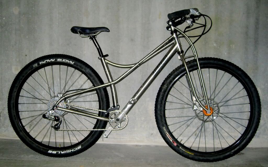

    Have had the Jones set up as a SS for some 13 months now, and I love it. I am doing a 4 day race in New Zealand called the Alpine Epic ( Many of you should next year come on down under and ride this race) There is substantial climbing, would love to do it SS, but that would mean my race partner would need to be SS also (have to race with a team mate constantly) so decided to go 1 x 9...
    A big heads up to Chad at the Barn, he built me a great wheel, CK hub, Stans Flow Rim and DT Comp spokes.... Also furnished me with a 11 - 34 cassette (of which the colour clashes big time with my mango hub.... ), XO short cage rear der, XO triggers. Have gone with a 991 hollowpin chain and went with a Rohloff chain guide.
    Everything went together perfect except for some mods I need to do on the chain guide (minor stuff) I did not even have to do one adjustment on the rear der, amazed me...
    The race is 25th Feb, so wanted to get a few rides in on a 1 x 9.....
    The things I noticed:
    - Having a rear der takes around 10% minimum efficiency away in my opinion. As soon as I stood up, which is habit from the SS I could notice it big time. Now am not complaining, just what I noticed.
    - Extra weight in the rear, again, not complaining, was just noticable
    - I usually run a 32 by 20 gearing, I cannot get a matching gear with the 1 x 9 that feels the same as my SS gear.
    When I ordered the Jones, I got NO cable guides at all, I didnt want it to be a breeze to swap to gears... But with zip ties, all is well....
    I feel it is a good choice I have made with the 1 x 9 for the race, as normal, am sure many will poo hoo me and think I am nuts riding the Jones, this happens often, this time I am going with my gut feeling and lifting the middle finger to all those negative peeps...
    A few shots:
    How she has been since I purchased her....
    As a 1 x 9, very temp I assure you...
    Any thoughts re 1 x 9 riding, fire away, keen to learn.....

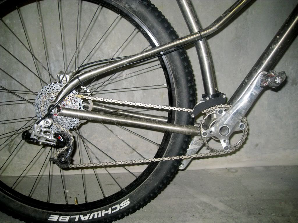

    Also, after trying a few different chainstops, in tandem w/ a bashguard, I realized a front derailleur would be more reliable and lighter. It looks like your chainguide rides on the chain, that would annoy me, although I bet the actual friction is negligible.

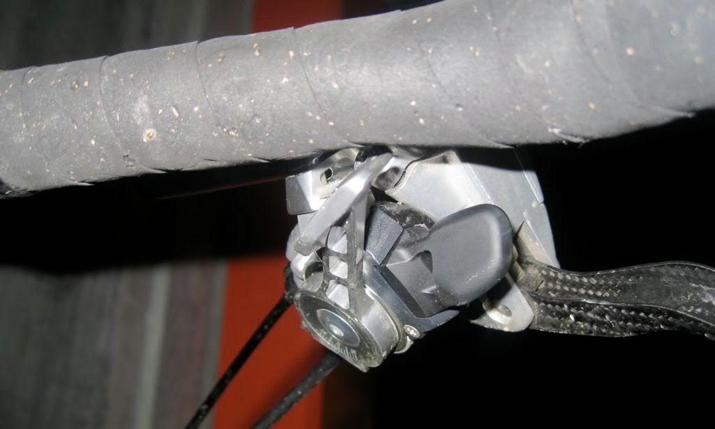

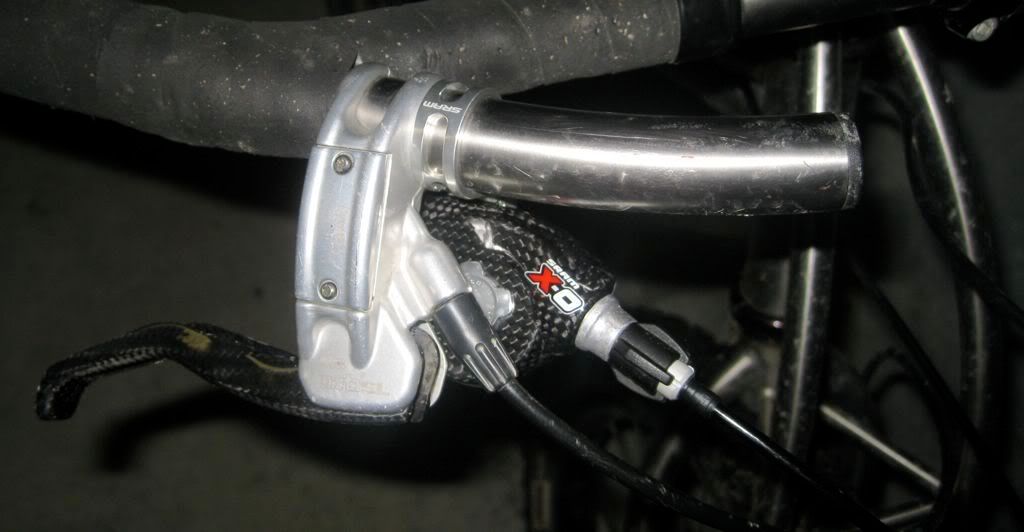

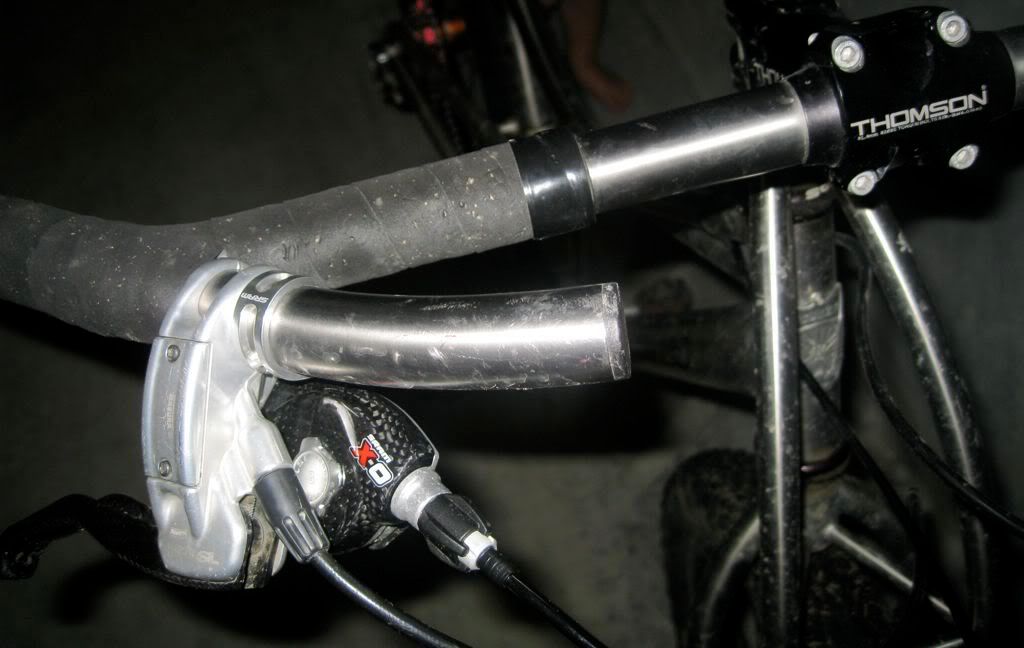

    how does the X0 trigger work on the H-bars? I have a pair that are usually on my SS but am building a commuter and want to run Sram shifters

    CB2 - the chain was not in a good place, am doing the final adjustments on the chain guide at this point. But agree with what you are saying after seeing the photo.

    Scooter - Having no problem with the XO Trigger on the H Bars, it is a bit more discrete for want of a better word on the my bars. But am more than happy with it..

    Why is the chain being pushed down by the guard in the front? It seems like that could be the cause of the extra drag you are feeling? I'm asking because I swapped my ss drivetrain out for a 1x3 setup for the winter, and I do not notice any difference in pedaling efficiency when pushing a similar gearing as before. I notice some extra drag on the bike stand spinning the cranks, or when back pedaling but it is nothing even close to 10% extra when compared to the energy I put in the cranks pedaling. The reason I suspect the top chain guard as the extra 10% when riding is because the friction against that guide on top would increase with chain tension. On my setup, the only extra drag is coming from the derailleur pulleys, and that friction does not change when the chain is under a heavy load (that tension is constant and supplied by the cage spring), so while it feels like a significant increase when freely spinning the cranks, it is negligible when pedaling the bike.
    4,574
    I'm pretty sure the chainguide is installed incorrectly. Doesn't it make a horrible sound set up like that?
    Here are the setup instructions. They don't look like there is supposed to be any touching between the chain and the guide.

    kapusta - The picture does show a horrible chain line. All the components arrived last Friday, we were going to road ride Saturday and mtb Sunday. But it turned out we rode mtb Saturday, so was a rush.... Hence the chain guide was not perfect, this has been fixed now. I never rode in the lowest gear, to much drag on the chain guide.....
    So appreciate your comments....
    I still feel there is a little drag compared to a straight SS...

    First time I've ever seen that Rohloff - what's pushing the chain down so weirdly? I always thought a tensioner should be on the slack side of the chain, never on the tight side (it'll just wear through your tensioner otherwise).
    Isn't the Rohloff just supposed to keep the chain from flipping off one side or the other?
    Just curious... I'm making some chain guides for the rear of my ss to do the same thing. Had a chain jump today and snapped it. At least it was downhill to my house!
