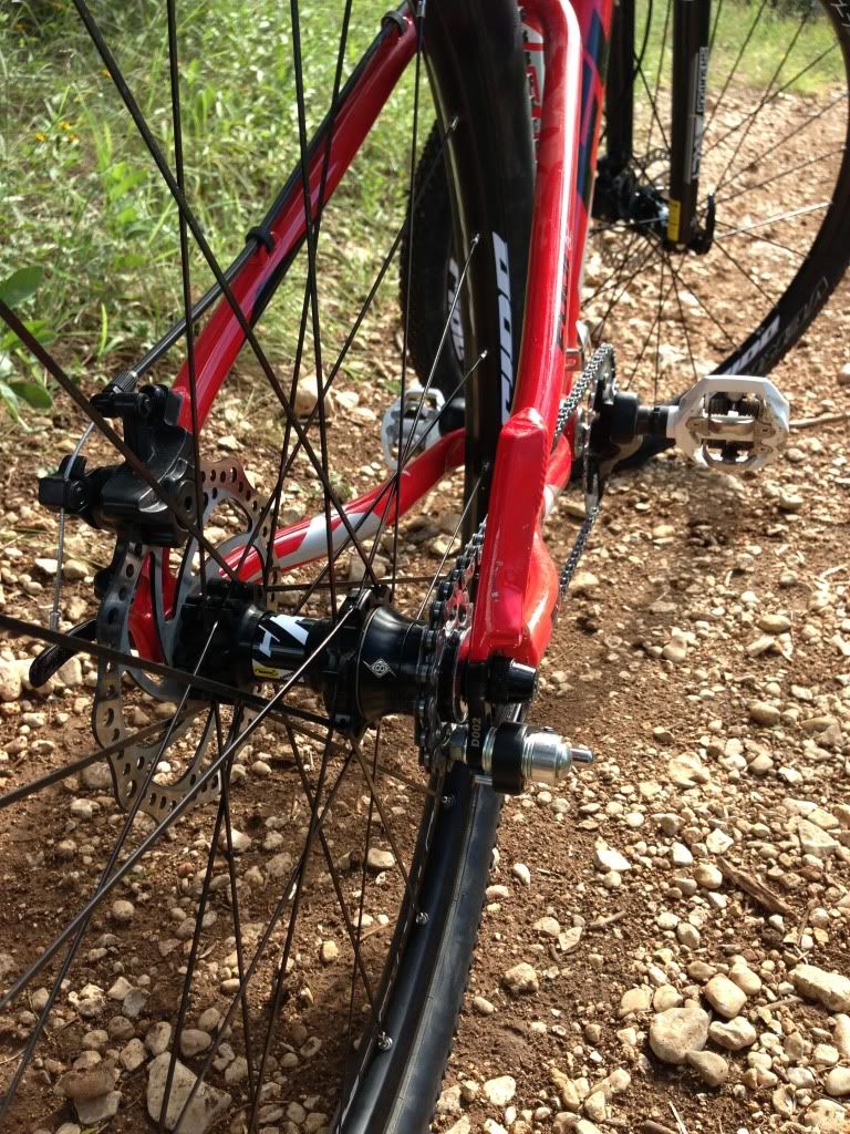

    All better now. Got some new Mavic cross ride wheels and a origin 8 singlespeed kit. Chainline is great and it rides oh so nice.

    I'm still sticking with the 32/18. Seems fine especially since I have my seat height correct now. I got some new Forte 720mm wide bars and a new Forte stem(not in these pics). Huge difference in handling today. Felt great in corners and riding through technical terrain.
    HTFU!
    Reputation: S.O.B.'s Avatar
    754
    Nice pics! Love the one of you climbing like a SS pro! Looks like your having fun and that's what it's all about.
