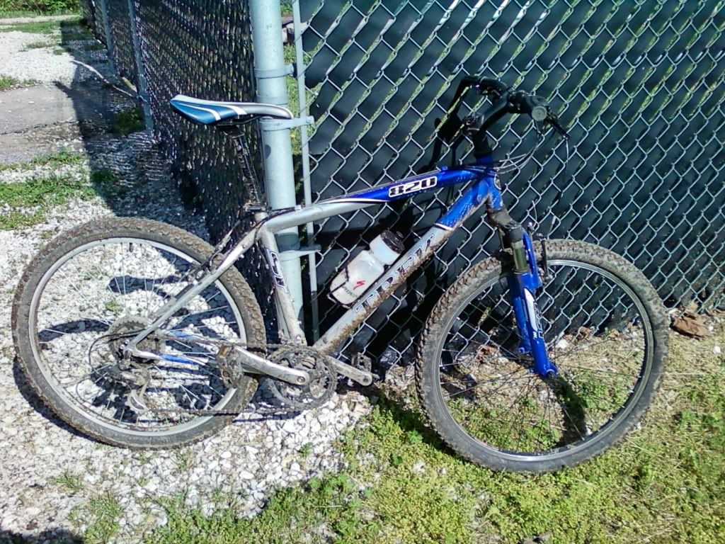

    Hello all, this is my first real meaningful post. I've been a long-time lurker, and recently joined to lurk some more, and now I'm looking forward to being a part of the community.
    I am beginning to undertake my first bike build, and hoping to really learn a lot and love my bike even more as a result. My everyday ride is a Giant XTC1 26er, having recently replaced the Trek 820 which will be the center of this thread.
    First a little about me, I'm a pharmacy student (so I have basically ZERO funds), and I first got into mountain biking when i was about 14 through my bro-in-law and other friends. The Giant was really my first big bike purchase, even if it was used and not that expensive. Now that I have a bike which can reliably get me around the trails for a while, I figure it's time to build a back-up and loaner bike, and learn a lot more about my bikes.
    When I looked at bikes, SS hardtail 29ers kept popping up as my main focus, but here in WV we have some hills, and I didn't want to go all-out on a SS. Most of these bikes were steel framed, and in my revelation, I already have a steel HT, albeit a 26er.
    So, here's my plan:
    Very, very, very low budget SS, and (I'm sure this will bring flaming) I'm building this bike solely off the image I've seen in my head. (the image in my head is of a much cheaper Kona Honzo, but with smaller wheels, low-end components and a much higher smiles/miles ratio and a lower bottom line)
    Frame- Trek 820
    Wheels- Stock at first, switching out later as funds allow
    Crankset- I currently have an old Deore XT crankset, so I hope to use it's middle ring
    Saddle,Bars,Stem - Cutter MTB saddle and lock-on grips, Ritchy comp stem 120mm, Sunline V1 flat bars
    Brakes- Stock V at first, then a cheap disk set as $ allows
    Fork - Probably going to end up with an XC32. Finding a decent super-cheap fork with lock-out and v-brake posts is difficult.
    SS gear -Sette tensioner, Surly conversion, 18-20t cog
    I want this bike to be my have fun, take a load off and enjoy the outdoors bike, with no gears to fiddle with, and no worries. I don't care if it comes out heavy, if it doesn't have the name factor that it should, I'm building it for me.... I would appreciate any input you guys have, anything you think I'm leaving out or forgetting, or any advice. I'm here to learn and have fun guys...

    well, i think my build is going to be a longer and more expensive build. while i just want to learn, i also want a decent bike in the end. So far i have accumulated grips, bar, saddle, stem, chain, headset, and some other odds and ends, and now getting to the bigger, more important stuff.
    so i think i am going to go with a RS Recon fork once funds allow.
    School me on cranksets though. I see some SS cranks for ~$100, and if these are any good, i'll probably go with one of them, like a RaceFace Evolve, or a truvativ stylo 1.1, or something similar.
    Any thoughts?

    honestly, the Trek 820 is a heavy, weak, flimsy bike to start out on. enjoy the process but don't expect too much out of that. an 820 with a Dart 3 is going to ride like a ton of bricks.
    Reputation: BeginnerCycling's Avatar
    1,091
    If you want the building experience, then you can certainly do what you mention. However, after recently going through a similar thought process, I decided I could by a BikesDirect Bullseye or a Nashbar 29er much cheaper than cobbling together a budget SS on my own (especially factoring in that I would need to buy headset & bottom bracket tools). Those bikes are around $400 delivered. I ended up with the Nashbar, and am pleased with the bike and that I saved time and money.
    So, IMHO I'd sell the Trek and the Dart, get one of those SS 29ers, put on your saddle, grips, bar if you like them better, and head out to the trails (or hit the books) with the extra time and extra money in my pocket. However, YMMV, and if the project itself is your stress outlet then by all means do it.

    thank you for the replies. and yes, i know i could buy a bullseye(which i do like that it's steel) or a nashbar, but if i am going to do that, i may as well buy a peace9r, and then i may as well get a rig, and then if i do that i may as well get a honzo.
    But then i'll have a very pricey bike and no real knowledge of how to take care or repair it when the instance arises. And at my riding skill, I won't outride the bike i'm sure. (i think that's one thing that many people tend to forget, having a baller bike does not make you an awesome rider)
    As you said, this bike is my stress outlet, the thing i can come home to, turn a wrench for a bit, and surf the web for parts. This bike will be a SS for cheaper than either the bullseye or nashbar bike.
    I'm actually amazed that the dart is lighter than i expected it to be. still not a feather of course.
    burnedthetoast
    223
    I wouldn't waste $100 on a SS-specific crankset for this build - just find something that will run a 32-34 tooth chainring (generally 104 BCD) and spend $15-30 on a SS-specific chainring (so your chain doesn't fall off as easily). I like Surly steel chainrings, they run around $30.
    Also, I suggest nixing the idea of getting a cheap set of disc brakes - you'd also have to swap out wheelsets and depending how low you go, both the wheelset and the brakes might end up being no better than what you've got on there. If you want to improve your brakes, get some new pads and some Avid FR-5 levers - $30-40 all told and a pretty significant improvement over most stock setups.

    definitely true. the only way anything disk will end up on this bike is if i upgrade the giant. i didn't make that clear. i'm still changing my plans as i go, but i really see no reason that this can't be a functional bike that can get me or a friend around when necessary.
    it's more about the fun of building it for me, and the fun of it being something i put time and sweat into instead of something i bought for really cheap online.
    burnedthetoast
    223
    Understand the fun of doing stuff yourself, I'm still riding the first singlespeed I built up and have done 2 others since then. Just a warning not to think $ = fun in terms of components - you're doing a budget build so don't get carried away! My 27-28lb SS (Monocog 29er w/ heavy wheels) is still a blast to ride, and the brakes on my budget/leftover-parts build (cheap shimano V's w/ Avid levers) stop me just fine.
