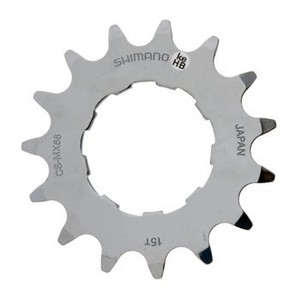

    Back on topic: not even all the 3/32" stuff is the same: some 3/32" cogs are a bit wider than others (like 2.2 vs 2.0 mm).
    For example these cheap stamped cogs with only the # of teeth stamped on them (sold as Gusset 1-ER and many other brand names)
    are wider than Shimano CS-MX66 cogs.
    If you have a slightly wider 3/32" cog a 9-speed chain might be too narrow for it, so in that case use an 8-speed chain, or a dedicated 3/32" SS chain like KMC Z610.
    After the cog has worn a bit, a 9-speed chain will probably fit.
