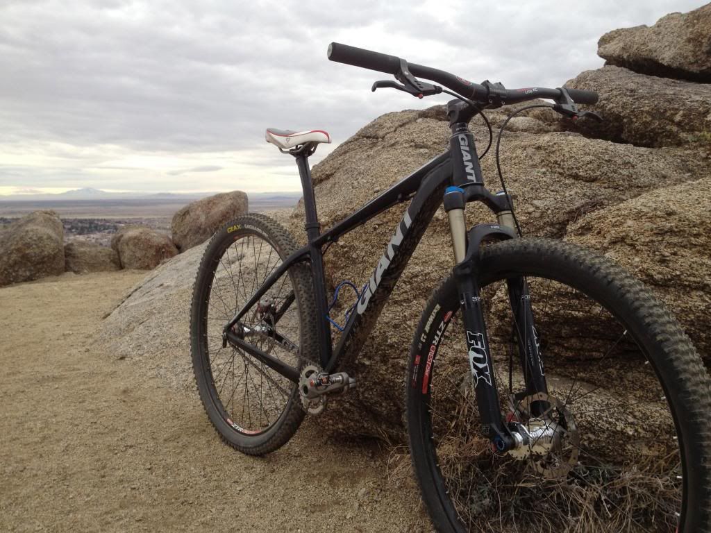

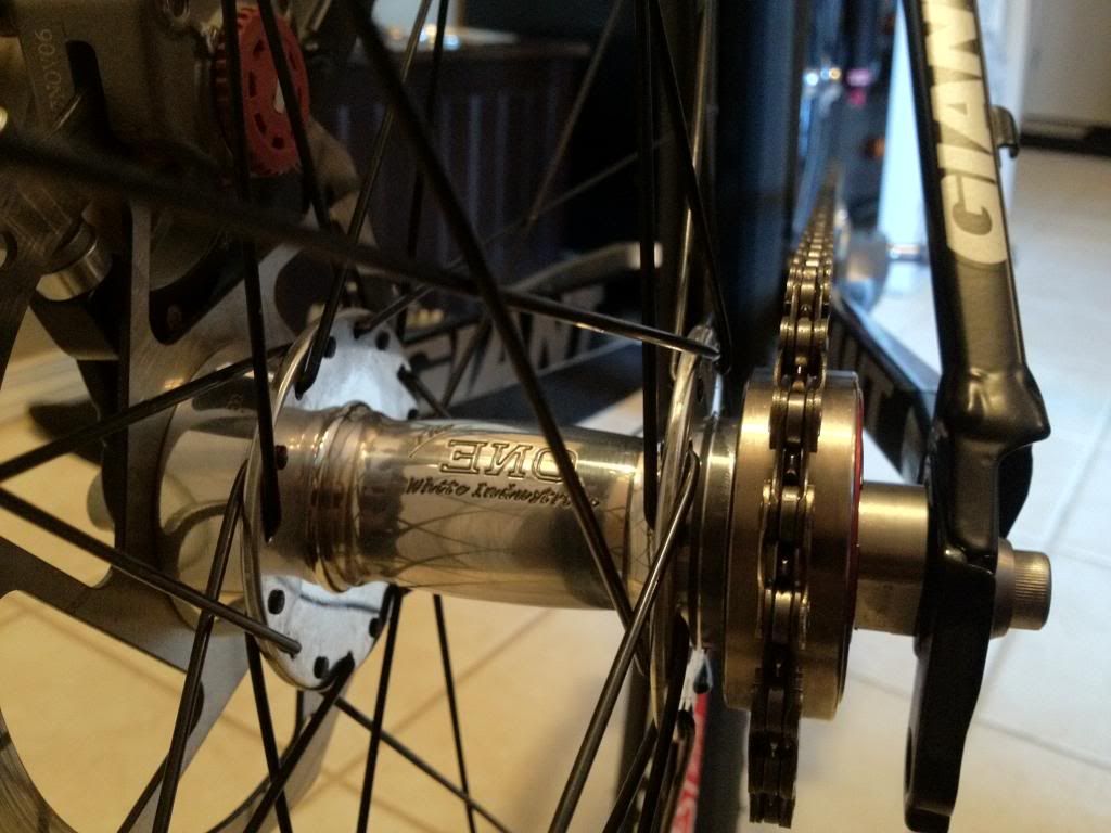

    I keep dropping my chain and yesterday I slammed my knee so hard onto my fork crown that I nearly picked my bike up and hucked it off a cliff. It's a 2012 Giant XTC 29er Aluminum frame and it flexes like a gay bodybuilder at a nude beach. The build is good with a Hive SS crankset and WI Eno Ecc rear hub and the Trials freewheel, bombproof. At first I thought it was the hub slipping so I sanded and knotched the dropouts just to be safe. Then I though it was my freewheel, which was a standard one but I replaced it with a $100 fancy schmancy WI trials one with 1 million teeth engagement and a rattlesnake inside. Then I thought it was the chain which was an 8-speed but I replaced it with the Sram singlespeed. Then I thought it was my alignment which was maybe .2 mm off so I went both ways with it a couple steps trying it after each and even put my chainring on the outside of the crank and tried that which was much worse. I got some custom shims and it's now maybe a red headed butt hair off at most! Basically, I've tried everything but replacing the frame. This entire build is only a few months old and less than 300 miles on it.
    If I stand on the pedal with the front brake applied I can get the chain to loosen up and get about an inch and a half of freeplay. I can take it off the freewheel if someone is standing on it. I showed this to my LBS and they pretty much agree that the frame just can't handle single-speeding but they were also the ones who recommended this frame to me (which does handle amazing!). Now they are telling me to get a SC highball alu because it is intended for SS'ing but at this point i've lost some confidence in their opinion. They are going to sell me the highball at cost to make up for a bad recommendation which is cool of them but is that aluminum frame going to be any better? Are they full of ****? Do I just need to suck it up and get a steel/ti/carbon SS specific frame? Anyone want to buy a Giant XTC 29er M frame and an eccentric hub? Any good recommendations for a Medium 29er SS frame for a 100mm fork?

    Haha, that's funny, we have pretty much the same build. I'm running a 32-18. Yes I could alleviate all this by running a tensioner or one of those sliding chain guides but that would defeat the whole purpose of the eccentric hub and all the money I spent on it..and I don't like clutter, and I'm not going to run a 39t chainring so I can run a 22t freewheel, which would be another $100 just for the freewheel!
    The flex is very noticeable on my frame at least, if you hold your front brake and pedal down how much slack can you put in the chain? I'll try to get a pic or something tomorrow to show but I go from really tight to REALLY loose, granted i'm built like a damn mule and put down some extreme torquage but I don't feel that should be happening regardless. I'm not necessarily opposed to "flex" but I am strongly opposed to chains coming off when I'm mashing up a hill. I dropped it off at the shop today and they are going to play with the alignment and test ride it tomorrow. I dropped off a 6 pack of some local DBA as well in case the test rider slams his face on the stem or his knee on the crown...or both. Hopefully I'll hear some good news like the alignment went out or something but I've pretty much concluded my investigations and am fairly certain it all comes down to frame flex. I hope not as I just built that damn thing but I can't see what else it would be. Here's mine (pic is old hub):

    That freewheel looks very small.
    How many teeth do you have in the back/front? From the way it looks, that may be your problem. Put a 20 tooth or larger freewheel on and I bet your problems will be gone. You can run a larger chainring to give you the same effective gear. The larger your combo is the better your bike will do in terms of chain tension issues.
    Also check your freewheel. I had an ACS freewheel on my first singlespeed and it was really bad with slop and play in the system. Compared to a WI freewheel or a normal cassette hub the cheap china made freewheel was penny wise and pound foolish because it wore out in a matter of weeks.

    Slow down and the read the thread. OP's last post answered your first question. His original post already mentioned he's running a WI trials with a gazillion points of engagement. There is zero wrong with his freewheel.
    128
    Based on the pic I'd suspect the chain isn't tight enough.
    I had problems before with an ebb where I sized the chain wrong on install because I wasn't thinking about the ebb. Another time with different gear combo on the same bike with the ebb it just wouldn't work with the gearing I chose. I had to choose between a half link or leaving the chain where it was at and installing a new front ring + one tooth. I chose changing the front ring +1 to a 33.

    Quote Originally Posted by FreeCoffee View Post
    (pic is old hub)
    I understand that you are not currently running that hub but in the pic the chain is SUPER loose to me. Maybe just a mock up or pre-adjustment in the pic and that's fine, but if your chain still looks like that you've found at least one problem.
    77
    As I said, that's an old pic, I've since updated both the chain and freewheel. I played with the alignment a little and got the chain tight, zero slack. I'm going to go for a couple hour ride and see what happens, hopefully I don't smash my nuts.

    The chain is a little lose in that photo - but I've run them like that all the time and no drops on my cheap steel frames.
    345
    Did you put a SRAM PC-1 chain on there? If so, that is the most elastic chain I've ever used. Try a KMC chain double check the chainline....
    Reputation: J.B. Weld's Avatar
    761
    Quote Originally Posted by wjphillips View Post
    That is bs. Whatever problems the OP is having a KMC chain sure isn't going to fix. That chain looks way loose in one of the pics but like SS said I've run them like that and still never dropped a chain.
    Seems weird but it does seem like something is up with that frame, especially since the shop agreed and it seems like Free Coffee checked most of the other boxes.
    I'm not saying that the chain couldn't be the problem, just that it isn't a brand problem.
    345
    I dunno. I used to love the PC-1 chain until I started having chain drop problems. I have track fork ends, and I kept tightening the chain but it would always pop off. It got so bad I had to tighten the chain after every ride. I switched to KMC and it works a lot better (for me). Chain hasn't popped off in over 600 miles.
    Another problem could be your front chain ring. If you pedal backwards, does the chain maintain its tension consistently? Are there loose spots then tight spots? That could cause the chain to pop off as well. You may need to re-align your front chain ring. You will never get it "perfect", but it could help. Large differences in tension could be the cause.
