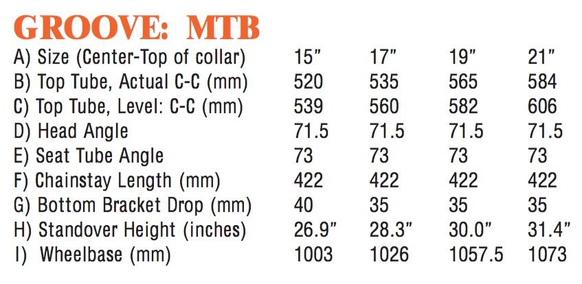

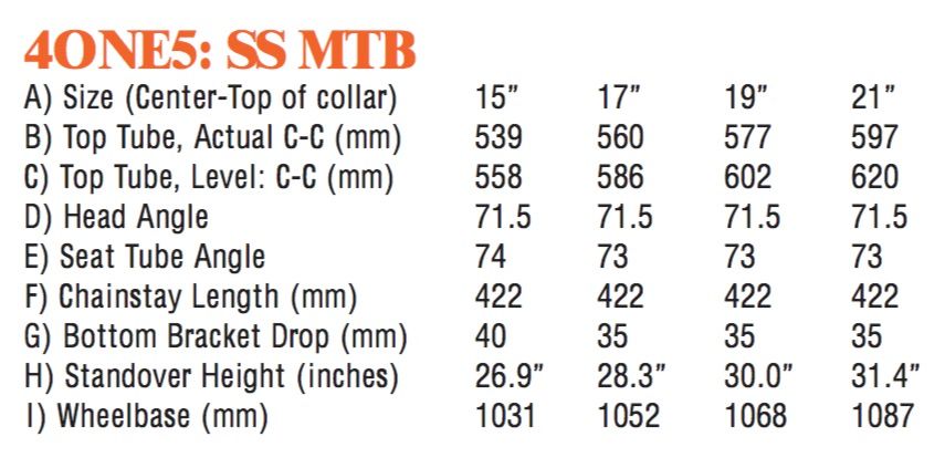

    Do you know where I can find the geometry chart for the Soma 4one5? Their site has bad links for all the geo pages.
    Is the 4one5 EXACTLY the same as the Soma Groove, except with Track Fork-End instead of vertical drops? (They have the geometry chart for the Groove, any possibility it's a perfect match?)
    425 is quite a drop from 445 on the CroMoto. I'm wondering why the Surly 1x1 is only 413mm, yet claims to be "susp corrected for 80mm", while the 445mm Cromoto is also susp corrected to 80mm. That's a huge difference. Is the 1x1 fork only "susp-corrected" on the 1x1 frame, because the 1x1 frame seems to have the exact same angles as the 4one5... All these numbers... Do they matter less than I'm worrying about?
    Here is a 2007 geometry chart
    Soma spec a 440mm fork for the 4one5 and Groove so to keep roughly the same geometry with a 29er front wheel I am going for a slightly shorter fork
    Not the same:

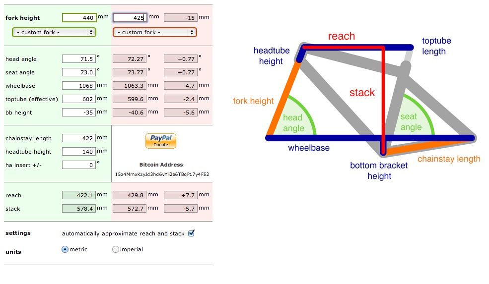

    Yes, some very different geometry figures from 425mm to 445mm:
