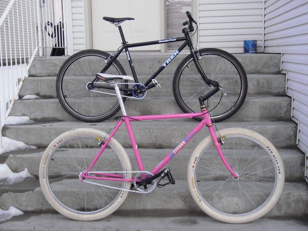

    This is my current project, a 1989 Fisher Celerity which I got for free, no, not from the dumpster. It has heavy Exage LX components with Biopace rings. At first, I wasn't so sure if I want to continue on with this conversion or just post it back again online for free.
    It was the PINK color that is turning me off but after thinking more about it, I decided that have to do this. I know it will take larger than average balls to ride this bike. Thirty minutes of elbow grease showed the true beauty of this 21 year old gal.
    Back then, Gary introduced his Evolution line of parts, which pretty much killed me. The steerer tube is 1 1/4 oversize, bigger than the most normal 1 1/8". No chance of replacing the forks, but MIGHT be able to run a 1 1/8 stem if I can find the right converter.
    Hopefully I can finish this one with least amount of money involved and try the Biopace rings with magic gear (fingers crossed). Pretty stoked for this pretty ugly bike.

    Mmm, not sure if you can find a magic gear with the biopace as it changes the # of teeth on your chain depending on where the cranks are at... Unless you run a tensioner.
    Isn't she a little chunky? She will make you stronger in whatever you do, I'm sure of it.
    Jan 2009
    7,415
    it should not be too hard to get a non-Biopace ring for that crank. everything else on that bike should be easy. does it have a freewheel or a freehub on the rear wheel?

    fortunately it is a freehub. i have few ss rings for this but really wanted to know what is the fuss about elliptical rings such as rotor rings. i saw a fixie conversion with biopace and hopefully i can recreate one too.

    Pink was the new black back then. Biopace will work without a sprung tensioner... you have the same chance of a magic gear working whether the ring is Bio or round.
    That will be a cool SS once it's set up.
    I have the same steering tube dilemma here. I'd like to convert a Yeti Ultimate that has a 1 1/4" steering tube. Is this the part you need?
    Nitto Mt Column Threadless Converter
    If you want to run a different fork you can get a Devolution headset from Chris King.

    Finally Done!
    Between busy work and family, I finally finished this cheap conversion. Running magic with 36:15 gearing on a Biopace chainring! The chain tension varies but insignificant. Eventually will be changed to drop bars and probably paint the fork black.

    Quote Originally Posted by fishcreek
    I like it! digging the white tires

    Thanks guys, yes I decided to keep the fork the way it is. The CK Devolution is a nice add-on but that headset alone will cost more than the bike itself plus a new fork. Actually the saddle on the bike is the most expensive part of this build LOL.
    Its a comfortable bike to ride especially with the riser bars, the stem length and angle is asking for drop bars though. Something about this bike puts a smile on my face whenever I see it, probably because most of the bikes I kept are black.
    There is a thread about JB welding a cassette hub, actually I searched pretty much every bike forums about it and of course there are lots of opinions, success and failure about it. I would give it a shot on this one and if it ever succeed, the rear brakes and mounts will go bye-bye.

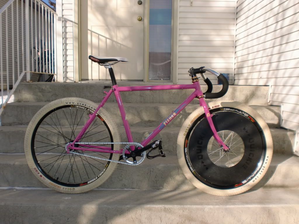

    tried track bars instead, measuring up, feels alright. about the brakes.. still to be decided.

    The tarck bar totally ruins it for me. I can't even imagine riding with what looks like 10 inches of drop from the saddle height to the grip area.

    Since it's cantis I think it would work okay with roadbike levers.
    It would look awesome if the crank is alu color with steel toe clips.

    running brakeless
    rear wheel is free from lbs's recycle bin, just need minor truing and is good to go, jb welding it tomorrow. front wheel from local classifieds, way stronger than the stock araya's. pictured with track bars, not too shabby really, but can easily switched to risers if needed.

    Man, that is a bit of a reach, but i've noticed that lots of people are more limber than meself, so...
    I'd past law on running a front brake with fixed gears. I see it fairly regularly in my area and I've seen a lot of dangerous situations that would have been avoided fairly easily with a front brake. It isn't something that you can avoid with skill development- it is physics. something like 70% of your stopping power comes from the front end braking and that cannot be replicated with skip stopping, end of story. Not to mention I've broken and thrown chains several times on road and off and one of those circumstances would have had me over the railing of a bridge....

    Clearly, reading is never a forum strong suit. I never said you can't ride without brakes, you just shouldn't. If not for yourself, for other people. It is not arguable- you can't stop nearly as quickly and it leaves you without a back up.
