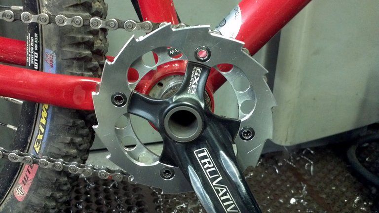

    Finally made my first chainring
    I have been riding my Raleigh XXIX for 5 years and have wanting to make a chainring for it. I have all of the tools, but it has been hard to get around to it while keeping up with the regular jobs. I finally got one done this week. Took it for a spin this morning.
    It's a 33T to replace the one Truvativ ring that came on the bike originally.

    I don't have a gram scale. I put it on my postal scale and it weighs somewhere between 40-50 grams. I didn't put much effort into making it light. Just wanted to try out the tooth profile. It worked fine on a quick 6-mile ride this morning.
    This one is machined out of 1/8" thick (3mm) 6061 material that I had on the shelf. I did it in two setups on my Fadal CNC mill. I ran the mounting holes, teeth and center bore in one operation and flipped it over to cut the step and ramp on the teeth on the other side. So it is very concentric: no runout. The teeth are machined to 2mm thickness. I will probably redo it with thicker teeth for the wider chain on my SS.
    What I learned so far: I need more clearance to mount the ring easily without removing the crank arm. I was barely able to get it over the spider. So cutouts are necessary.

    How did you design it?
    Magura :)
    Math and CAD. ;) I used my old standby BobCAD V17. The software is 15 years old, but it's quick and efficient. For more complex stuff like fork crowns and 3D hot rod parts, I use a newer version of BobCAD.

    Yeah, but I cheated in the execution. I have CNC mills. Your rotary table chainring is impressive.
    I honestly was a little lost at first, but I found some very helpful info on drawing sprockets that got me rolling.

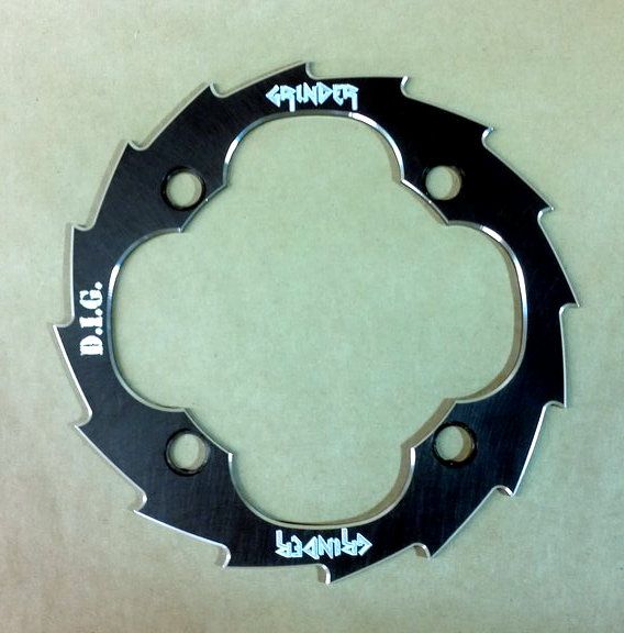

    While the machine was set up, I ran a revised version of the bash guard I have had on my Blur.
  • 11-27-2012
    wyatt79m
    That looks really nice
  • 11-27-2012
    phsycle
    Wow, I'd like one of those. Current bash guard is a porker.

    TheMachinist
    This one is ridiculously light. It looks like it barely tips the scale over to .03 kg, so I'm guessing low 30s until I weigh it on an accurate scale.

  • 11-29-2012
    TheMachinist
    Originally Posted by Mr.Magura View Post
    You really got the itch :thumbsup:
    I did a similar design years ago. It turned out to be too weak, and collapsed under heavy load.
    I did a revised version later where I did the cutouts pretty much the same, but with an end mill with a radius from both sides, and left a thin wall in the center. That one worked well.
    Were the cutouts triangular like mine? How long did it take for the chainring to fail?
    I made the lightweight one a 32T and put it on my Blur. I am itching to get out and ride it, but the rain is hitting us pretty hard here.

    TheMachinist
    Originally Posted by cdn-dave View Post
    @icantdrive - how did you figure out the height/squareness of the teeth and how does it perform? I rounded mine off (in CAD)
    I just copied what is already out there and working. It works great so far. I have not had much chance to test it out since the first ride. We are getting hit with a pretty decent storm right now.

    On another note, love your designs so far, the bash guard is beefy and should handle a lot of abuse. :thumbsup:
    Thanks. I have just been using 1/8" 6061 sheet that I have on the shelf. I am having trouble finding a supplier for thin 7075 sheet. At least an affordable one.

    Magura :)
    The question is: Do people want a lightweight chainring or do they want one that stands up to abuse? Aren't bash guards for people who want to grind logs and rocks? Just trying to find the balance. Now I want to mount it on the XXIX without a bash guard.
    I took the lightweight ring out for a spin on my Blur today. I forgot what it's like to shift from the granny gear to the middle without all the pins and ramps on modern chainrings.:D

  • 12-05-2012
    TheMachinist
    Originally Posted by sasquatch rides a SS View Post
    If anybody needs any testing done on their chainrings I would gladly do the job for you :)
    BCD and tooth count? I could use some outside R&D. I have been riding the lightweight ring on both of my bikes, but can't get out much between rainstorms for the last week.
  • 12-05-2012
    TheMachinist
    Originally Posted by ozzybmx View Post
    You are a prime candidate to take on HBC's client list.... have a go at a 29t spiderless middleburn and i'll send you some cash and test it for you ;)
    One speedbump I am running into is that I don't have all of these different cranksets to measure and test fit for splined chainrings. I honestly don't know much about them.
    I do have an old XTR crankset circa ~2000-2002. Too bad those are out of vogue.

    TheMachinist
    Finished up a bash guard.
  • 01-01-2013
    fishcreek
    i never liked bash guards, cool nonetheless, reminds me of 90's bash's.. what is D.I.G.?
  • 01-01-2013
    TheMachinist
    Originally Posted by fishcreek View Post
    what is D.I.G.?
    Dirt Is Good
