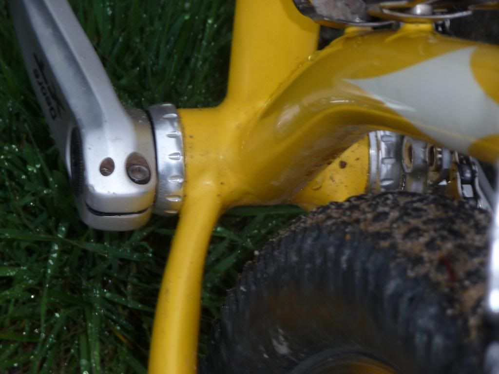

    Just switched to Middleburn cranks ...
    and they are awesome. The initial build of this SS included the RaceFace Evolve (external BB) cranks and while they were adequate, I didn't know what I was missing until I purchased and had installed a set of RS-7 square taper cranks. I mated these with the Phil Wood titaninium BB and I cannot believe the difference in stiffness, power, and smoothness over the middle of the road RaceFace crankset I was running.

    I have only been using the King since May, but it's working great. It has made it through a number of rides, like Agate creek, that destroy BB's completely unscathed. Plus it is pretty smooth and smoothly pretty.
