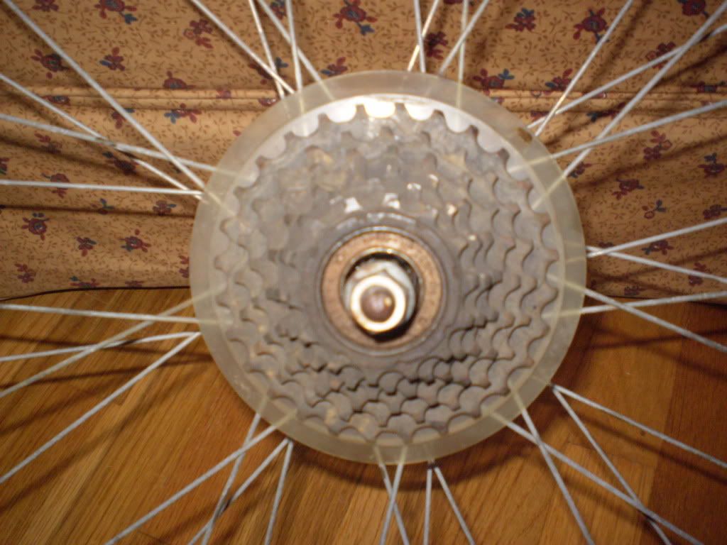

    So my nieghbor left this Mongoose bike outside for months after he moved. He abandoned it over 6 months ago so I "aquired" it. I stripped it down and am going to make it a single speed. Its a cheap bike, maybe a $200-$300 rigid bike and its gotta be 10-15 years old. My question can I convert the old style rear wheel to single speed? I'm not familiar with old style hubs, I know the SS conversion kits work for new hubs with a lock ring and a slide on cassette.
    One pic is with the axle, in the other its with it out.

    its a free wheel
    your going to need one of these and a lot of raw power:
    http://www.jensonusa.com/store/produ...ool+Fr-1C.aspx
    after that you can throw on a freewheel and attempt to squeeze the 120mm gap that is left behind on the chain stays( i found it quite difficult to align the FW with the chain ring)
    good luck

    OK thanks, it looks like too much time and effort remove the free wheel.......
    Next question, should I keep the existing freewheel and just run a single speed chain?

    Originally when I converted recently I bought a BMX chain (1/8) but man was it ever heavy, plus it wasn't the most flexible thing ever, so I swapped back to the 8 speed chain (3/32) my bike came with and I've been digging it ever since.
    But ultimately, I kept the same chain and same freewheel. I just slapped on some spacers and a single speed cog and used a chain break tool to get the chain the proper length to run as a single.
    I intend to keep running on this setup for quite a long time to come. I do, however, have a new chain tensioner coming, which is something else you might want to consider if your bike has vertical dropouts.
    Take it to a bike shop and that freewheel will be off in under a minute
    Then the fun starts, you'll have to respace the axle and redish the wheel to get a decent chain line.
    It's not a big deal, but it's not automatic either.

    Ok, so I solved my dilema of gettig the free wheel off the "donated" 1990s Mongoose Manuever. I took it to the LBS and took the freewheel off no problem and put on a BMX 16tooth freewheel. While I was there I picked up a single Tektro V-brake, lever, a 7/8 speed chain and some brake cable/housing. I also stopped for some matte black spray paint. Total costs so far:
    Spray paint - $7
    BMX 16t free wheel - $9
    KMC SS chain - $13
    Tektro V brake and lever - $19
    brake cable/housing - $3
    I began by sanding the crap out the frame. The most difficult part was sanding of the logos, but they came off with some elbow grease and 150 grit sand paper. Then I washed it, let it dry and rubbed it down with rubbing alcohol to make sure it was super clean. Here's the before pic, ready for paint.
    I left the cranks on because all the rings are riveted together so rather than buying a new SS crankset, I'll just use the 32 middle ring and hope it stays on. I also left the stem and bar on mostly because it would be a hassle to swap them.
    All the parts went on smooth. It is nice touch that the frame has (almost) horizontal drop outs, makes getting the chain tension much easier. The only pain was rebuilding the rear hub but she's up and running except for grips and non plastic pedals. Not bad for $50 and a trashed bike.
    Thanks to all those helped me get the freewheel off.
