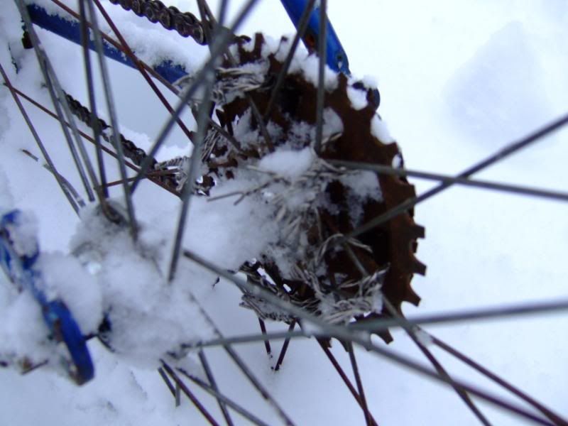

    How ghetto do feel like being? This is a technique which has been confirmed to last several winters of use and counting. Not pretty, but probably not deadly either.
    2,217
    If your freehub body has a seal on the back, you can remove it and braze the body to the cone, effectively immobilizing the freehub, while being out nothing but a roll of brass wire.
