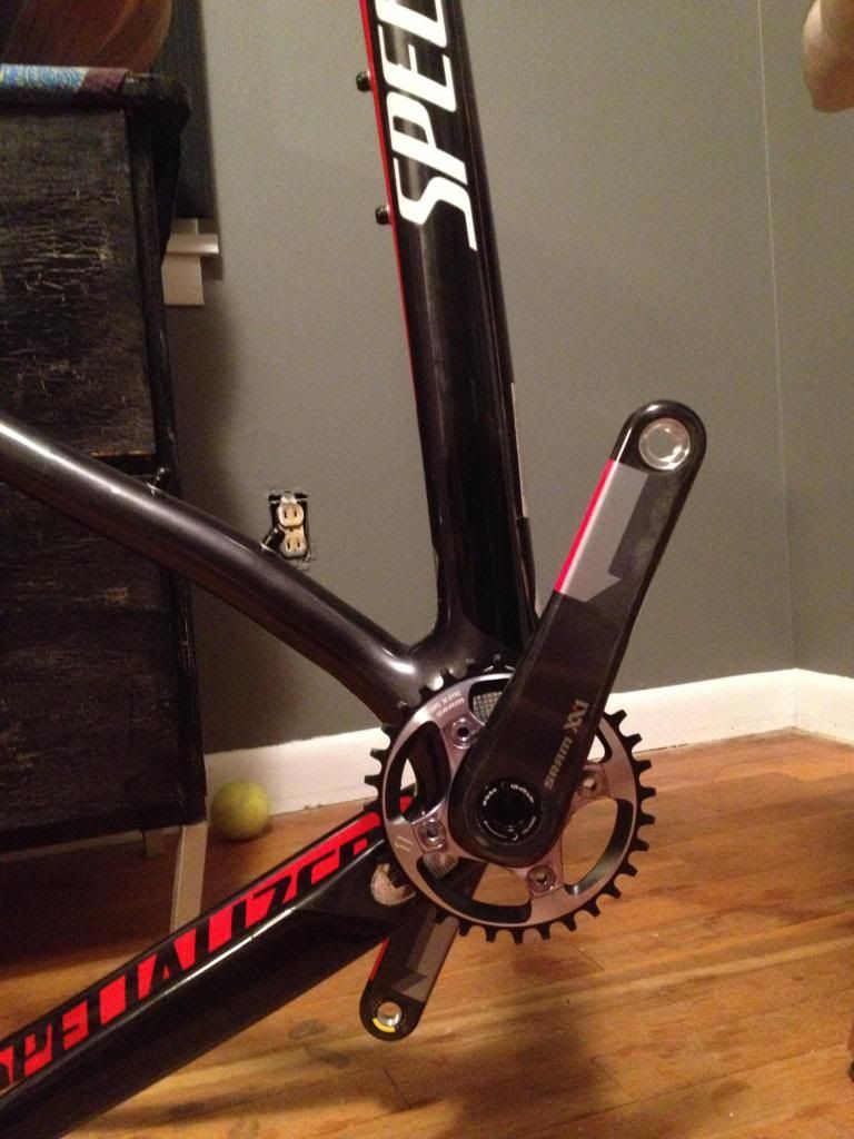

    Here's what I put on my Specialized Carbon Stumpjumper SS 29.
    I haven't finished building my wheelset yet, so I have yet to ride it. I'll throw on some old WTBs I have lying around just to see how it rides tomorrow.
    excited about this! :
    I know they're not SS specific but I got front and rear for $350 bucks. Can't beat that! I just ordered a set of Stan's Arch EX 29 hoops today too! Exciting times for me

    Quote Originally Posted by austinTRON View Post
    What chain are you running with the xx1 cranks? Can you run a standard 104 BCD ring if you choose to?

    I'm running a 32T MRP Bling Ring on the XX1 crank and SRAM PC-850 chain to my Surly cog. The Bling Ring brought my chainline out ~2.5mm as I recall.

    Yeah I'm running Surly 18T cog and Sram PC-850 chain and everything runs just fine.
