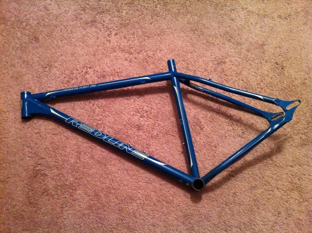

    '08 Monocog Flight Make-Over (Lots of Pics)
    Hey guys, So I have been wanting to freshen up my Monocog Flight for some time now, but until recently the weather had been too good for me to justify missing out on some good riding for a while. Well now it is cold in the mornings, with the sun thawing the ground out by the afternoon, so our local trails are all mush most of the time right now anyway so I can deal without that for a while now.
    This is my attempt at keeping me from buying a new frame to, well... just to buy a new frame as some of you guys may know the urge. I have a list of frames that I love and have almost pulled the trigger on, but thankfully my better judgment has stopped me from doing that. This Monocog works perfectly for me and I have yet to find a legitimate reason to not like it yet, so why spend the money on a new frame when this one works great....

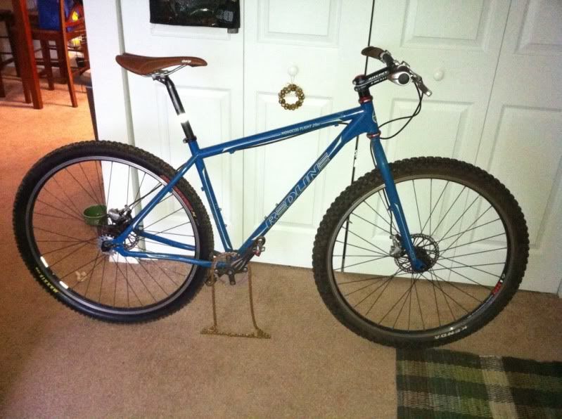

    As the bike sits today with tons of caked on crap on the wheels and the whole bike a mess in general, it weighs in at 25lb 14oz

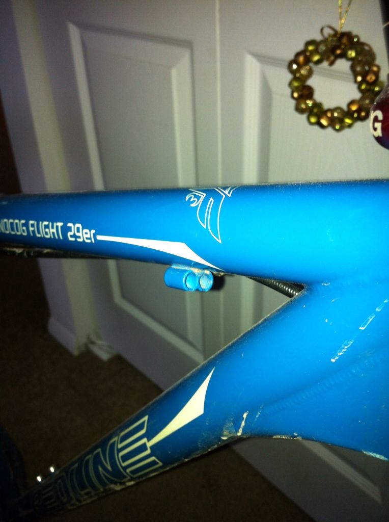

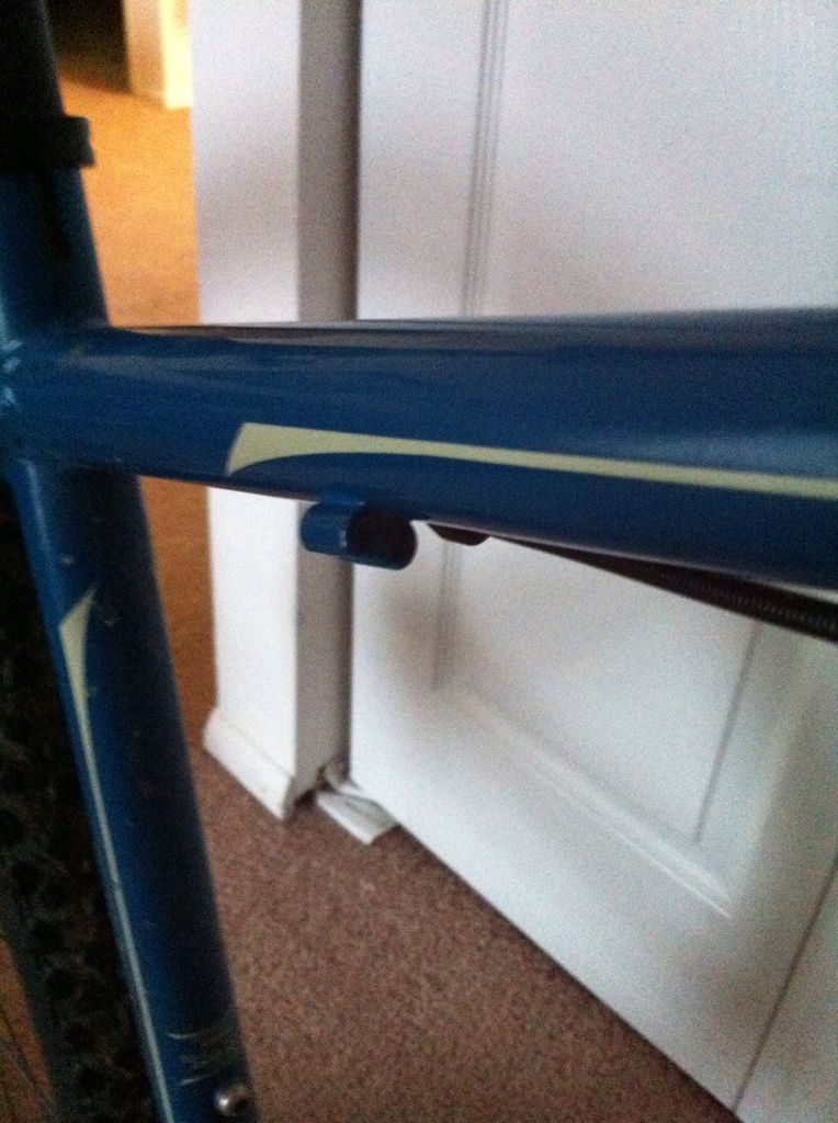

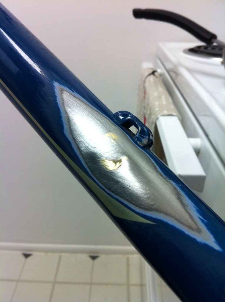

    Below shows all of the cable stops I plan on removing...
    Love how simple it is to take apart a single speed.....

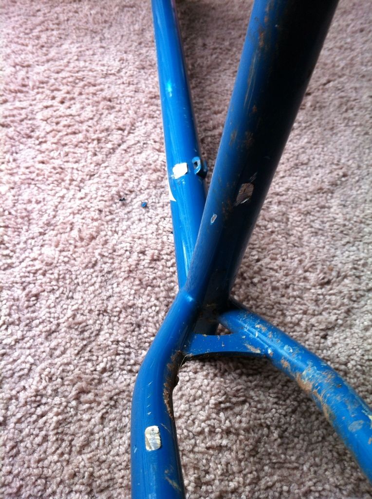

    A hacksaw and some patience was all that was needed to chop these bad boys off.... There of videos on YouTube that go through the whole process, but for those who don't know, you just need to hack the stop off, file it smooth, and then finish it up with sandpaper......
    The stops all cut off.... The double stops on the top tube were a PITA to say the least and I got a little too anxious on the first on and pried it off when I thought I had gone through it enough.... You'll see why that was a mistake in a second.....
    I wish I had a smaller more sensitive scale because I am curious of how much those stops weighed in the end.. Obviously I filed a ton of material down as well, but those pieces felt a lot heavier than I expected...

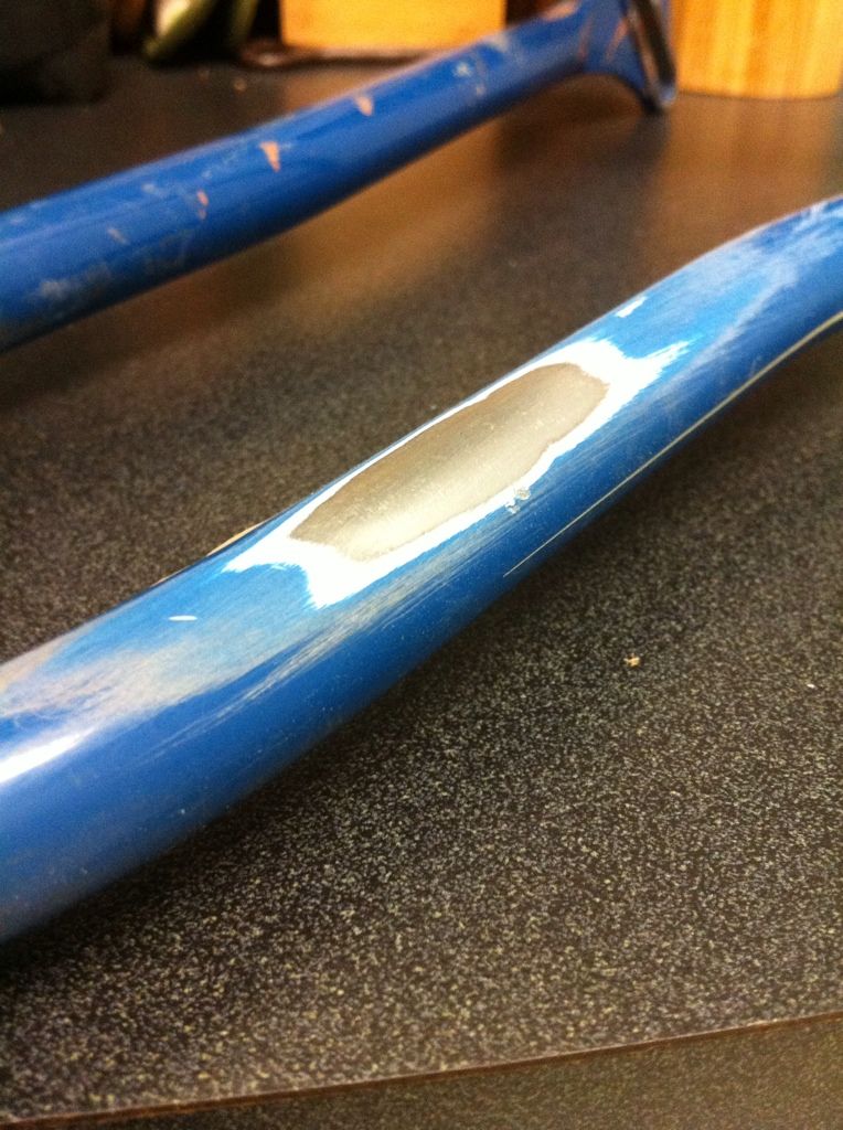

    All filed down.....
    All sanded and smooth....

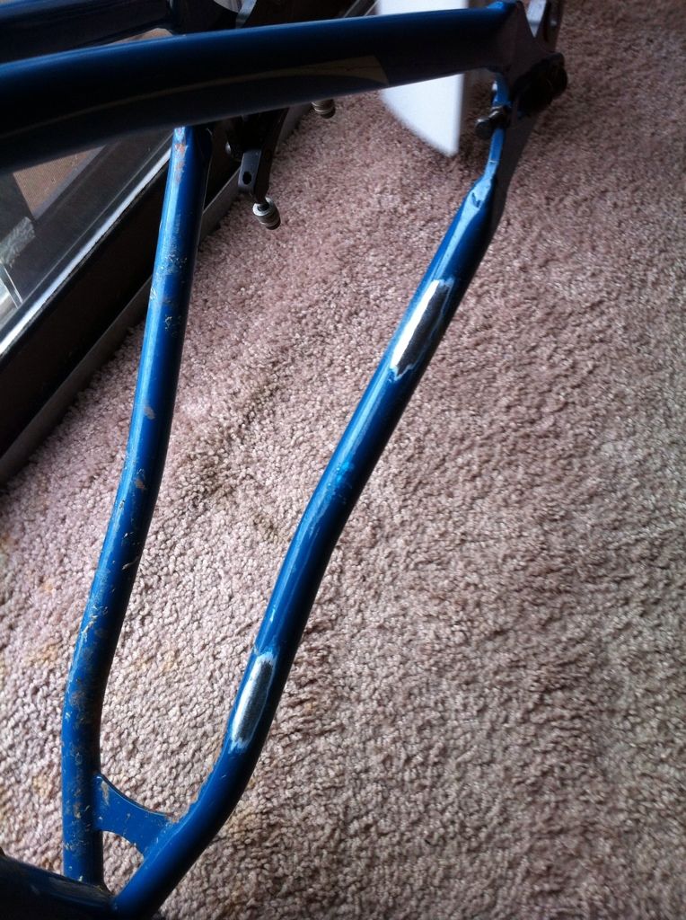

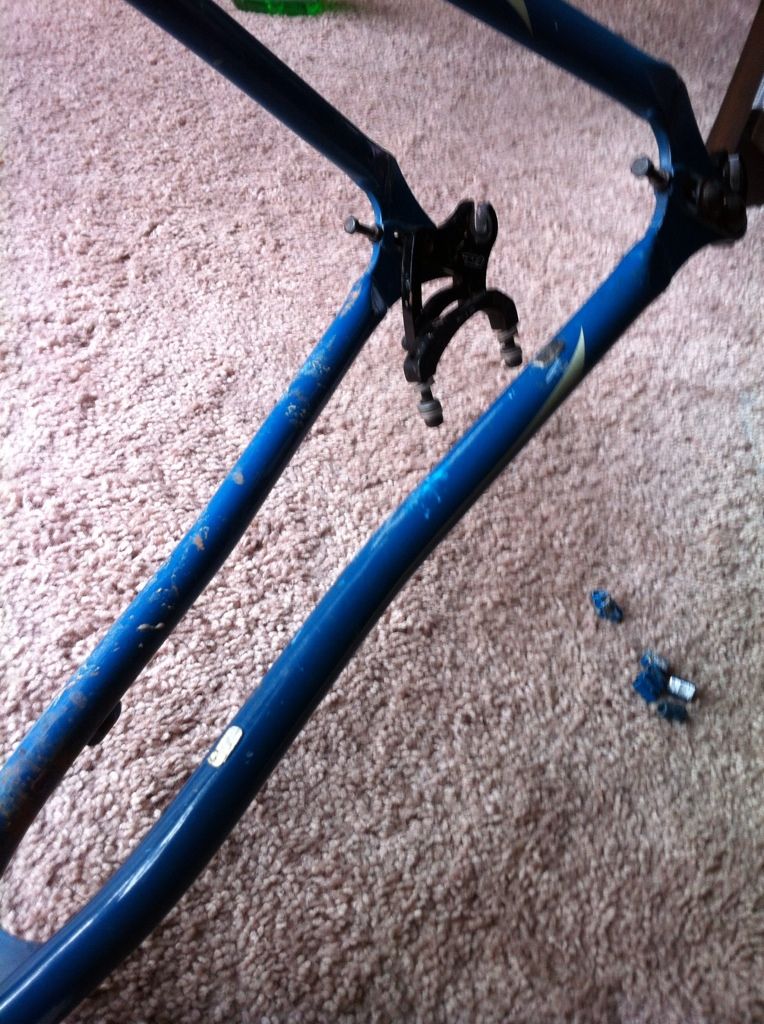

    I got myself a little bit of a dent there now from prying the stop off, but it really looks worse in the picture than in real life and I plan on doing a matte grey finish on the powder coating so it should hide it a bit. I havenít talked to the guy yet but, we may be able to use some sort of filler or what have you...

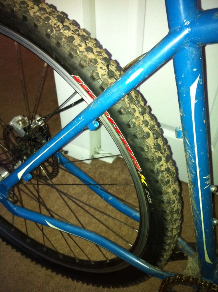

    As you can see the guides for the rear brake were right next to the cable stops. this is why it was so annoying to file and sand these guys down.... the back three stops were a piece of cake, but these ones took some time and finesse to not gouge the tube because of the awkward angles I have to file at.... It worked out in the end and everything is plenty smooth for me....

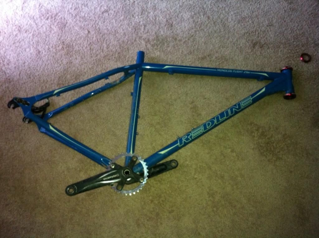

    So thatís where Iím at now.... I work a couple hours a week at a major Recreational Equipment retailer as a second job to break up the 9-5 throughout the week, so I made a run down to the stop and borrowed a couple tools so I could remove my headset, crank arms, bottom bracket, and crownrace....

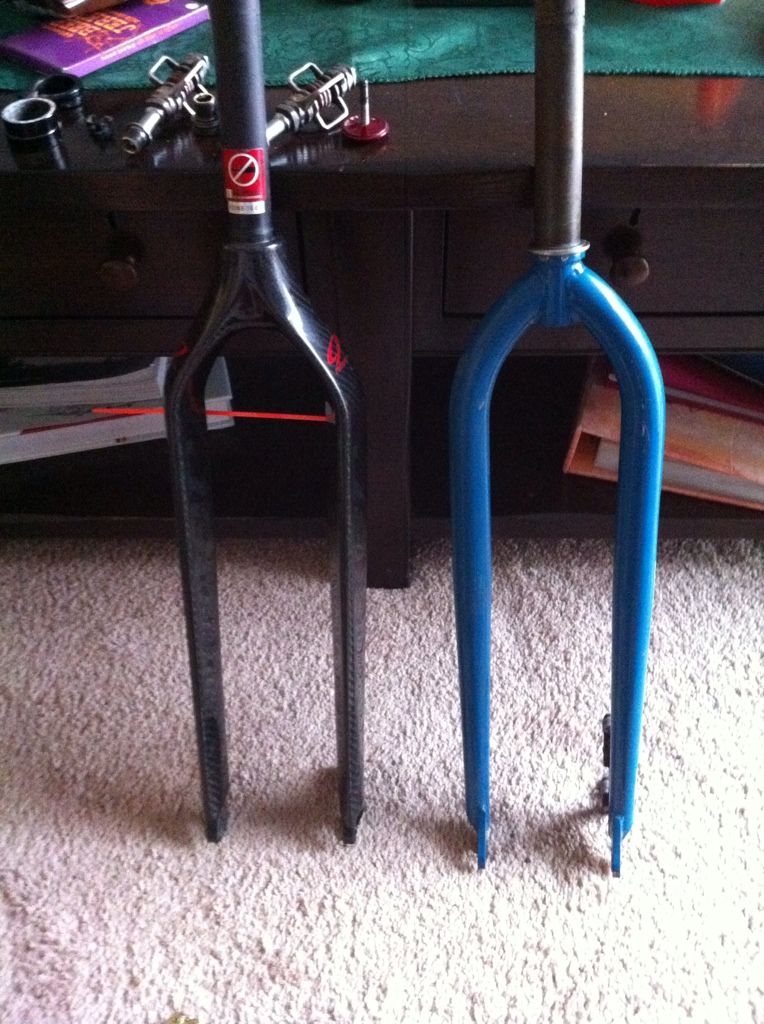

    I also installed the crownrace onto this guy below...VVVVVV (Pic taken before it was installed)
    ^^^^^The stock steel fork weighs 3lbs (w/brake adapter) and the Niner weighs 1lb 4oz (w/crown race, compression plug, topcap).

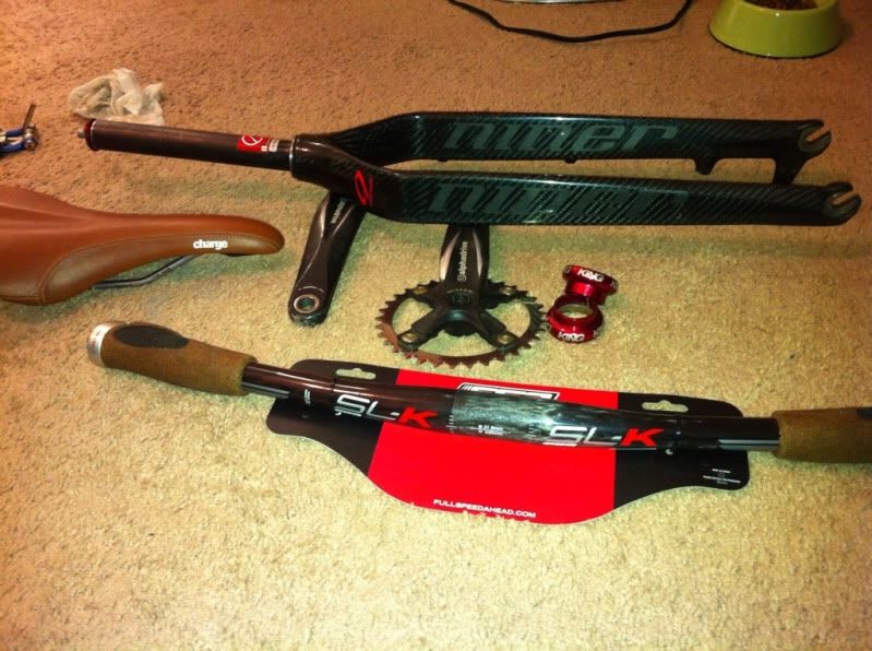

    A glimpse of what is to come...... only the fork and bars are new to this bike, everything else were take-offs...... I have a little baggy of hardware that I need to bring to home depot or wherever to check the thread pitches so I can order some Ti and/ or Stainless steel bolts and washers for the main slider bolts, the fine adjustment/ slip preventer bolts, and my brake post bolts just to freshen them up and more importantly strengthen those areas up...
    New chain and seatpost clamp..... I have a brand new Thomson setback seatpost and stem in the mail so I am stoked for them to come in....

    A little JB Weld will fill in the dent, you can sand it smooth and you'll never know it's there after a nice powdercoat.

    Quote Originally Posted by Bike Whisperer View Post
    Great Project! I can't wait to see the finished product!
    I have also had great results with using Alvin Products Lab metal to fix inperfections before powder coating. It is strong enough to withstand the high temps that the power coating requires.
    Powder Coating Filler | Epoxy Repair Putty | Filler for Powder Coating | Powder Coat Filler
