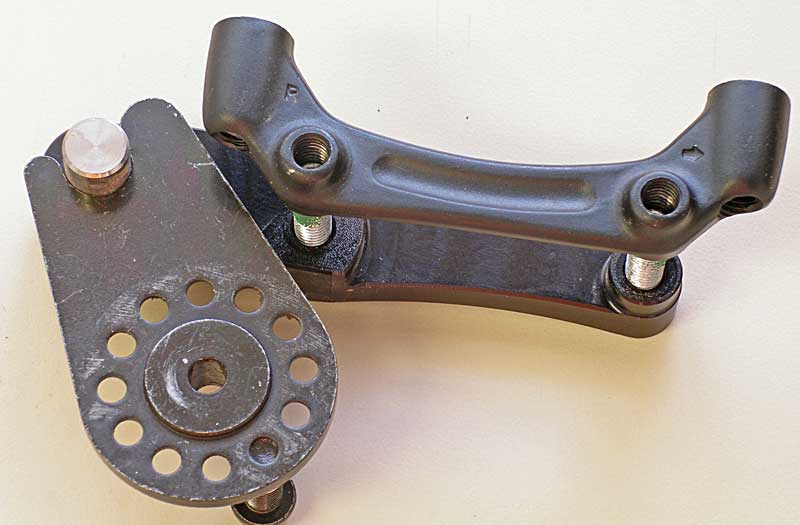

New 30g Speedbone replacement for Speedhub!
Neil from Cycle Monkey, in his spare time between some pretty wicked custom wheel builds, came up with a super-clean, weight-saving alternative to Rohloff's Speedbone. He was telling me about this just a few months ago, and yesterday dropped one of his first production samples into my hands.
Neil says he hasn't got a name for it yet. I'm suggesting "Brake Bone" just to keep with the Speedbone theme, but for this post, I'll just refer to it as the "adapter."
Now, to be fair, I don't know who should get credit for this idea, since I've seen posts and heard stories of other Speedhub users modifying their stock disc brake adapters to do something similar. However, it all derives from Rohloff's early foresight to design their OEM2 axle plate to engage directly with the rear-most IS mounting hole, which, initially, was a Speedbone alternative only if the user wasn't running a disc brake on their disc-compatible frame.
In any case, here it is. Check it out.

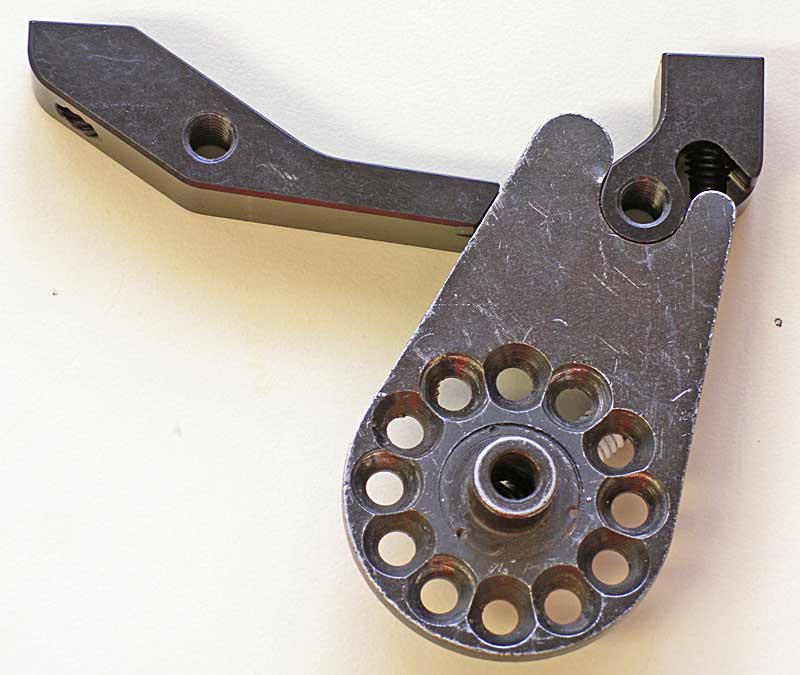

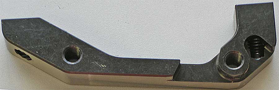

It's pretty much just an ordinary IS to post mount caliper adapter, modified with some well-placed slots.
This means, of course, that you've got to have a 74mm PM-style caliper, ala Avid, Hayes, some Shimano, Formula, and Magura units. (Did I miss any?)
____________________

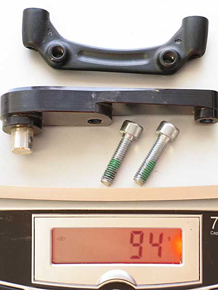

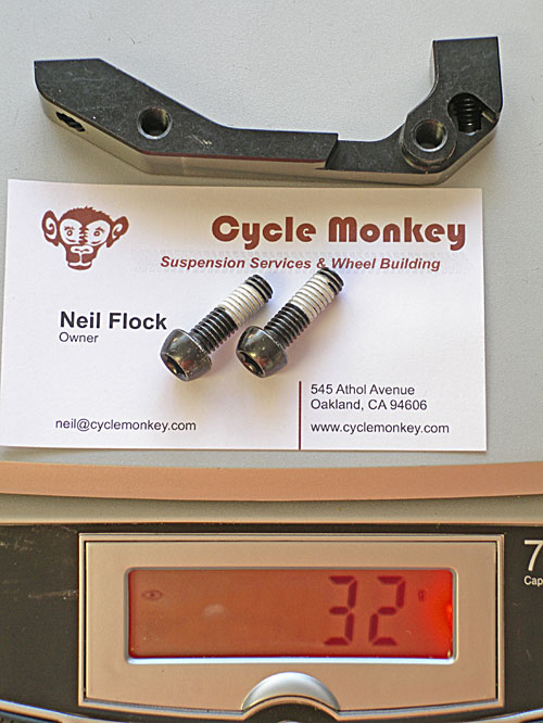

The adapter (plus the two original mounting bolts that came with your brake) weighs in at a svelte 32g. Note that the bolts are not included.
This replaces the original brake adapter, the Speedbone, and the two longer Rohloff-provided mounting bolts, which weigh in at 94g.
(new adapter)
(the parts being replaced)

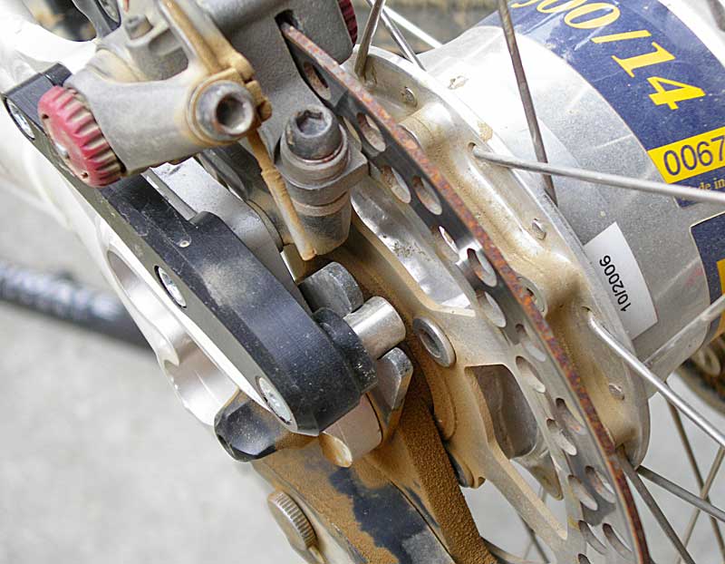

For those non-Speedhub owners browsing this thread, here's a shot of the Speedbone in action. Note the silver "nub" extending in towards the wheel, engaged from underneath by a plate mounted to the Speedhub.
Here's the same thing (Speedbone, disc brake adapter, and axle plate), off the bike.

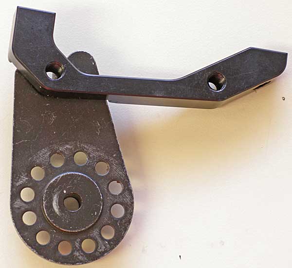

Cycle Money's adapter interfaces with the axle plate like this...
(from the right, looking out from the hub)
(from the left, looking in towards the disc tab)

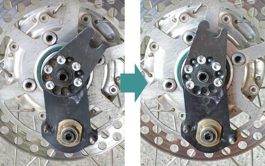

It's a simple installation, but will require the axle plate to be dismounted and rotated one to two slots counterclockwise.
Here are the before and after shots. The new adapter serves to clean up the appearance of the bike by eliminating the Speedbone.
It also makes wheel insertion extremely intuitive, because the Speedhub's axle plate engages the adapter in roughly the same upward direction as it enters the vertical dropouts.
The 62g saved isn't going to noticable to any but the most agro weight weenie, but Hey!, it's something.
As you can see, this is going to position the external shifter box in a slightly different orientation from where it sits using the Speedbone.
(before)
(after)

Neil is sourcing these in small quantities from a local machine shop, and is pricing the adapters at $35. He can be contacted through his www.CycleMonkey.com website. Rohloff is apparently on board, and will distribute them to vendors through their normal distribution channels.
Installation was as straight-forward as you'd expect. My only cautionary note: if you currently run any washers between your frame's tabs and the disc brake adapter, as spacers (and I do, on two of my Avid-equipped bikes), you'll need to make sure those washers are small enough in diameter (~10mm O.D.) that they won't interfere with the slot in the Speedhub's axle plate.
Fortunately, Avid includes two washers with their brakes *perfect* for this duty. You can see them in the second-to-last photo, sandwiched under the heads of the CPS/caliper mounting bolts. You'll note in the last photo, they've been replaced with larger-diameter hardware store washers; the Avid washers are now squeezed between the frame's IS tabs and Neil's adapter. (And again, this isn't a concern unless you are already using washers to bump in your existing caliper alignment... this new adapter conforms to IS standards, and will duplicate whatever caliper alignment you have now).

What's curious is whether this proves to be lighter than the OEM1 mounting option.
The OEM1 axle plate, mated to a frame with a Speedhub-specific dropout, plus a forged Avid brake adapter weighs 58g (37g axle plate + 21g forged adapter). But this 58g total does not include the extra material in the extended dropout, which could easily total another 20 to 30g (wild guess).
Neil's adapter, by comparison, totals 70g (42g axle plate + 28g machined adapter). But there is no extra frame material involved. And it arguably has a cleaner appearance.
Either way, it's close to a wash in weight. And there is no added expense or difficulty in frame design, as conventional vertical dropouts will suffice.
Again, I'm no weight weenie (the weight of the Speedbone was trivial to me), but analytically, the preferred OEM1 mounting method may have just lost favor for all except those with non-standard IS tabs (chainstay mounted), or with no disc tabs. Ironic, because a frame I've been waiting 8 months for -- with custom Speedhub-specific dropouts -- will be arriving in the coming weeks.

Nate, thanks for the detailed photos showing exactly how it installs!
Neil

Sorry Nate, but the 'bone has been known to break bikes...
I've know, as I've had three frame failures, and I know of two others in my immediate circle that have done the same while using a bone.
I've gone back to the torque arm, as those bones put a LOT of stress into the frame, and while it's an elegant solution to using the (to some) unsightly torque arm, beware, if you do enough riding, there may be tears in your future...
But it doesn't stop me from using the Rohloff, it's just something to be aware of.

I was beginning to think I'm the only one that prefers the torque arm over the speedbone.
The things I prefer about the toque arm:
1. It comes with the Rohloff so it doesn't add cost
2. Considering the amount of force a disc brake puts on a seatstay, it's nice to be able to isolate this from the torque the Rohloff is puts out.
3. The torque arm looks kind of retro - kin to the coaster brakes of my youth
4. The torque arm does a pretty good job of protecting the lower majority of a 6" rotor from impact.
5. In my application (IronHorse MKIII) the position of the external click box is higher while using the OEM1 plate, providing a little more clearance for trail obstacles.
All is not perfect, however. The one thing I'm not too fond of are the cheesey hose clamps that are included in the kit. Kind of a generic and cheap looking. I'm still using them but I'm in the process of building an aluminum mount block that will replace the one that comes in the kit.
Speedbone, Monkeybone, Torque arm...Sweet hub all the same!
I have all sorts of questions, because I haven't even seen a picture posted of one of these failures.
Did the failed tabs meet Rohloff's specs? I can't locate a thickness requirement, though I recall it was 6 or 7mm. They call for a 6mm wall width around the mounting hole, and that the tabs be machined from / same piece as the dropout (not welded separately to the chainstay).
I'm curious what the failure looked like. Was it from clockwise (forward) rotation? Did it break the tubing, or crack a weld? Were they all similar looking?
I'm not questioning your claim, just very interested in seeing what happened. I took Rohloff's liability waiver, and all of their cautions, when I first used a Speedbone on an NRS. Stopped paying attention after that -- must have figured if I couldn't break an NRS, I'd be OK on everything else. I'd love to see a photo of a failure if you have one to share.
__________________
speedub.nate
· MTBR Hiatus UFN ·
Speedub.Nate is offline   Reply With Quote
Hi Nate. all of the failures were of a similar nature. Two were on alloy FS 29'ers and one on a steel hardtail 29'er. I don't want to mention brands here as it is unfair to the manufacturers, but the hardtail was a custom and the builder was specifically asked to build to Rohloffs specs, but didn't and the bike eventually broke. He repaired the frame for me and followed Rohloffs specs, but a little to late!
The first of the FS alloy frames was sold to me on the belief of the supplier that the Rohloff would be fine, but wasn't, and the second (different manufacturer) meet a similar fate, after telling the builder of my woes and I had his absolute belief and guarrantee that there wouldn't be an issue. That frame broke after seven months, and he has subseqently re-modelled the chainstay. A sister bike bought at the same time broke in exactly the same place after two years of riding, but he doesn't do as much as I, or is as hard on gear apparantly.
we ride a lot of very steep stuff and it seems that the braking forces together with the Rohloff torque input, and quite possibly the extra stresses impossed by the larger wheel amplifying the torque enhances the problem. You get a situation where braking and torque forces are push-pulling against each other, and we all know aluminium doesn't handle those sort of forces very well.
Here are some pix for you.

Wow, all very impressive, especially photo #1 which appears to be a steel frame using a Rohloff-specific dropout (no Speedbone involved, I assume?).
So far I've had no frame failures to speak of. Going back to 2001, between my wife and I, I've had the Speedhub installed on the following list of aluminum frames:
