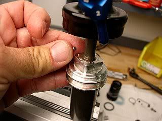

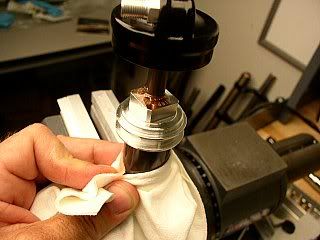

    Here is the vavling assembly.
    Seems to have both firm comp. and firm rebound valving.

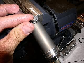

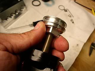

    I realized after reviewing many exploded views and pics that the pos air schrader valve was a 36tpi where it threaded into the body. This is only important because the tpi for the grub screw (where the nitro is held) is 24tpi. So, I decided that I'd try tapping my donor valve to see if I could use it in place of the grub screw for the nitro chamber.
    I realize that it seems mildly redundent to purchase the nitro safety needle and then try to fit a schrader valve for the nitro chamber, but I had only found a few saying that they had tried and found it mildly successful. Figured I'd give it a go since I had nothing to loose. Also had the advantage of working with the 1st gen Trance frame and I have MORE than enough room to turn the bottom of the shock body 180 degrees. Running the schrader valve for the nitro opposite the PP lever.
    Also had a 24tpi Die at work, so this was a no brainer. I had no problems turning new courser threads into the finer threaded body. I had to turn down the 'hex' area that allows you to tighten the schrader, but after removing them I filed 2 flat spots to allow tightening.
    *One thing to note. I had read where others had tried the schrader valve for the nitro and had a problem leaking due to the high pressures in there. After a few attempts at filling through the schrader valve I realized that I needed to tighten the valve 3/4 of the way, Fill to 300psi and tighten the valve down before releasing the pump. This effectivley 'pinches' the rubber seal the is behind the schrader valve. Therefor the valve is not responsible for holding the pressure, the rubber disk is.
    Here it is holding pressure just fine.

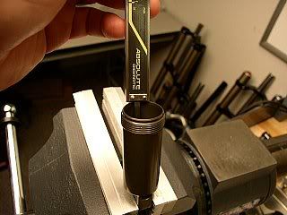

    1) What was the IFP depth and how did you set it?

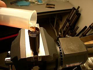

    Not sure what length shock is on the Trance. IFP depth on 165mm stroke Fox shocks is 1.9", IFP pressure should be 400psi.
    Bleeding these shocks is extremely easy. Once IPF depth is set, fill damper to the brim with oil, remove bleed screw and ball on damper assembly, make sure damper rod is extended as far as possible, insert slowly into damper and excess oil will come out the bleed screw. Put ball and bleed screw back in place.
    DO NOT cycle the damper until you have the IFP up to pressure.

    1) IFP depth is 1.90" for my 165x38mm shock (6.5x1.5)
    Set using a digital caliper.
    2) I followed the procedure outlined in the Fox AirShox directions.
    They specifically tell you to depress the piston assy. before refilling with nitro (air) and as the nitro chamber is filled the piston will rise to it's proper height.
    Not to contradict what Tig said, but I've had zero problems rebuilding my shock this way.

    Tig, thanks to you I had a starting point with the info you had posted and an idea of what to expect inside these things!
    First off let me explain the 2 methods I have used to refill the damper oil and nitro chamber.
    1st Method:
    1- set IFP depth with a micrometer
    2- fill damper chamber with 10wt
    3- close OFF IFP chamber grub screw (sealing IFP chamber and creating a vaccum)
    4- with the piston all the way up, touching the bearing head and without the steel ball,
    slowly insert into damper oil and begin threading by hand. If oil comes out of the bleed
    port, things are all good.
    5- drop in steel ball and tighten grub screw
    6- with the nitro chamber still sealed, I depressed the piston down into the oil
    7- with the piston all the way down, I began to refill the nitro chamber to 300psi
    8- as the nitro chamber fills, the piston begins to rise
    9- air up the main chamber and ride!
    2nd Method:
    3- with the piston all the way up, touching the bearing head and without the steel ball,
    4- drop in steel ball and tighten grub screw
    5- fill nitro chamber to 300psi
    6- air up main chamber and ride!
    I was able to put some good miles on the shock last night again (after the rebuild, WITHOUT depressing the piston) and everything was good. The shock feels really good right now!
    I'm ordering a 400psi shock pump in the next day or two so that I can play with the IFP pressure some more and I'll report back on that.
    Joe

    Place the damper body into a soft-jaw vise and fill the body to the top with 10 wt. FOX Suspension Fluid.
    Push the bearing housing all the way down to the topout plate on the back side of the damper piston.
    Push the bearing housing downward into the oil, and wiggle it back and forth as you thread the bearing housing onto the body threads. This will help oil pass around the damper piston as it lowers into the damper body. As you thread the bearing housing onto the body, you will see oil flow out of the bleed port on top of the bearing housing; this is normal. If oil does not come out, you should unthread the bearing housing, top off the body with oil, and try again.
    Drop the steel ball into the bleed port and thread in the set screw. Tighten to 15 in-lbs (1.03 N-m).
    Install a new rubber pellet into the damper body. Using nitrogen, pressurize to 400 psi and torque the filler screw to 14 in-lbs. (0.97 N-m).
    This is straight from Fox.
    This is how I do it.
