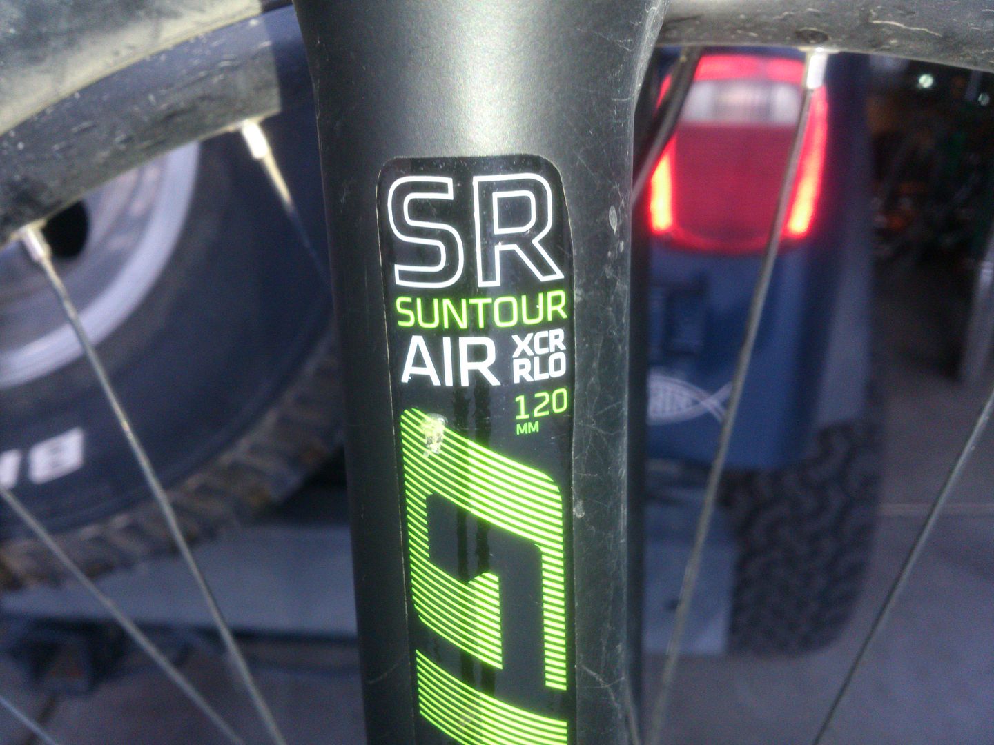

    Will this work on an XCR air? And I'm not sure how much to add on each side, 35ml seems like a lot to me.

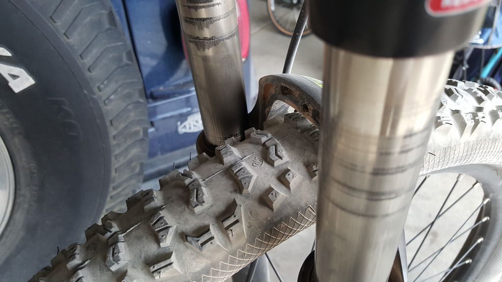

    This is what the black grease looks like.
    some weird crazed desert dweller.

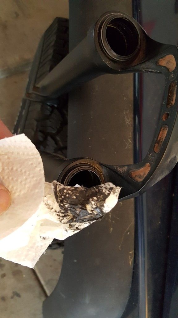

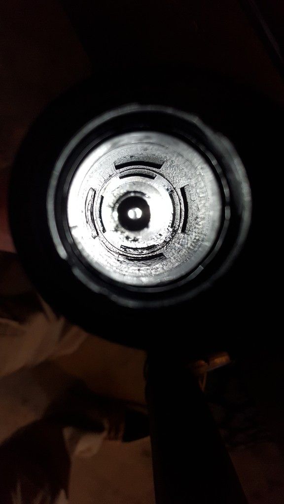

    Cleaned out the lowers like you would a rifle/shotgun, except I used a very long screwdriver with a ball of duct tape on the end wrapped in old tube socks and paper towels lol! Took quite a while and got rid of some old nasty socks
    View with a flashlight up the bottom hole like a bore scope.
    Dirty
    Clean

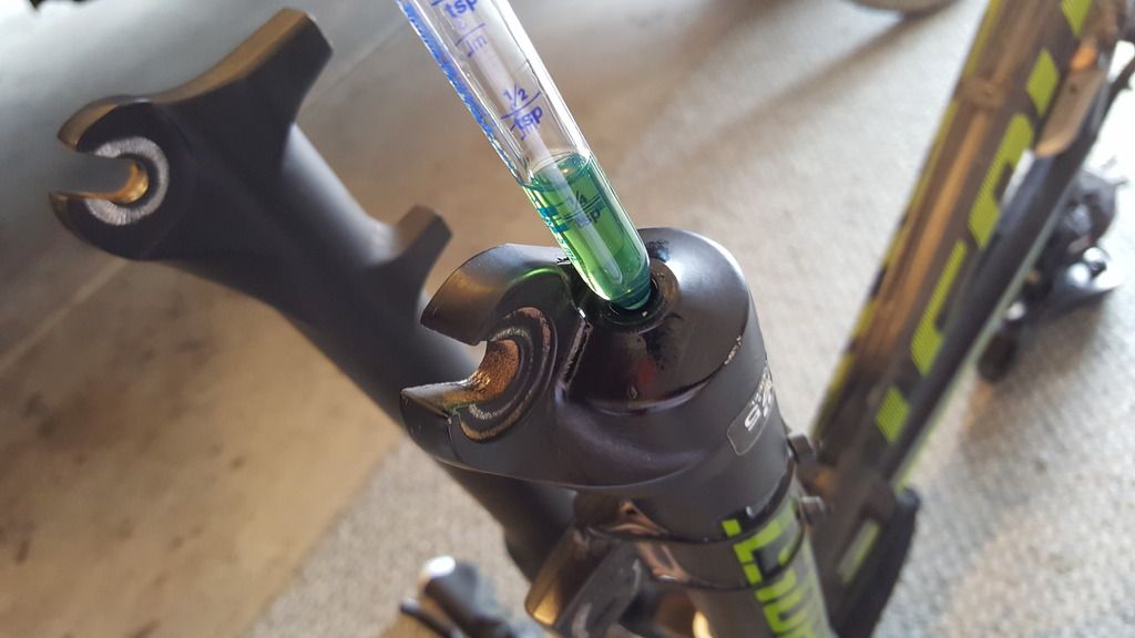

    Where to put the fork oil, I used about 15 ml per side.
    Some of the stuff needed. I used Bel Ray 10w I grabbed off the shelf at the motorcycle shop down the street. Grease for the wipes, loctite for the caliper bolts etc.

    I just spent the day disassembling, cleaning, adding motor oil, and reassembling.
    Yes, as you state above, I wrongly thought the oil/subject of this thread was fluid for a fork damper rod. With perfect hindsight, the oil's sum total purpose is to lube the stanchion tube/bearing interface. I used Honda motorcycle crank case oil, 10-40W IIRC, likely as good or better than anything else for this purpose.
    I shall just delete my whole post above after posting this update. BTW, I have indeed used ATF at least a dozen times to lube mc fork damper rods, where it functions as good as dedicated fork fluid. In fact, I would bet $10 to a donut that OEM mc makers recommended ATF for this purpose back in 70s/80s (that's 19, not 18!) Again, I'm old, and owned about 75 motorcycles.
    Two side benefits during today's exercise: It was a perfect opportunity to add grease to my fork bearings, which Spec, in their infinite wisdom, omitted during original assembly. (Wow, just like a $99 Walmart special, what a crock!) Plus Spec employs a plain bearing below, with semi-sealed ball bearing race above. Water/moister has easy access lacking the grease, which I applied in abundance and wiped away the excess after re-assembly.
    Also, I found quite a ding on one of the fork tubes, at the exact location that would increase stiction at the bottom of the stroke. I sanded the tube smooth, and I'm sure this could only increase performance. (I bought the bike second hand.)

    With the fork damper from my Raidon in my hands, the stiction at the bottom of the stroke (full extension, where it's most needed for small bumps), was obvious. Judged by the sensation in my hands, it seems like cheap damper rod. (Disclaimer: I purchased 2nd hand. A prior owner might have abused this fork.)

    Remember though, one of the fork stanchion tubes had moderate to severe nick/deformity, caused by I don't know who or what. After about thirty minutes of sanding it looked and felt close to perfect.

    Thank you Ablefonseca for starting this thread.and Praivo for directions on putting in oil
    I have a my16 Auron 29er
    that lately has been feeling wooden as of late ( esp after downieville)-- actually it felt somewhat wooden brand new but improved a bit when I cut down the volume spacer to nothing practically
    I turned over the bike
    used 15cc of Castrol synthetic 10/40 per side
    left the bike inverted over night-- no leaks
    never took off the lower or addressed the seals
    and the next day the fork was performing the best ever-- even better than brand new.
    will report back in a couple of months--
