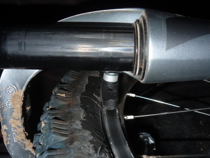

    Well I brought the bike in for some warranty repair.
    The fork is super stiff with little give. You can see where the paint is rubbing off.
    09 Marin Bolinas Ridge
    Singletrack Slayer
    Reputation: DavidNeiles's Avatar
    1,936
    Ya much better. +1 for the 318, Fork looks toasted.

    Figure I update. The bike shop took apart the fork and found something got stuck which wouldn't let to compress as normal. Greased her up and put it all back together and it's been running strong since.
