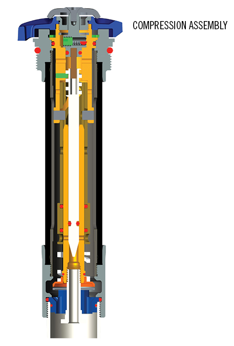

    Tech help needed....
    Today the RCT3 knob worked its way loose on a ride. It started to rattle and I couldn't dial in the compression settings.
    Took the compression knobs off. Pretty simple.
    I'd like to know if I'm missing any parts. Also if during reassembly where does SRAM recommend loctite and/or grease?
    I can't find the service manual for dealing with the compression damper. Anyone know who can give me a link.
    In order of disassembly:
    1. Tiny hex head screw holding on the LSC knob.
    2. Proprietary, threaded, nut-like black part. About the diameter of a penny, that screws down/within the main/large compression knob. It secures the main adjustment knob to the damper.
    3. Main/large compression knob. Appears to sit directly on top of a knurled/jagged circular rim of metal that when turned adjusts the main modes: Open, Trail, Descend. Seems that it is only the friction between the jagged surface of this part and the main knob is what allows it to be adjusted. I was wondering if there is perhaps a part that should be between the two? Something like a thin plastic washer or O-ring. Seems like an unusual interface.
    Finally during reassembly it seems like there is no special way to replace the main knob except that you should likely install it with the main adjustment full counterclockwise to Open.
    Seems like when I put it back together the Trail settings seem much stiffer than before. That is highly subjective and likely my imagination.
    Thoughts?
  90. #290

  91. #291
    moaaar shimz
    Reputation: tacubaya's Avatar
    9,116
    This should help!
  92. #292
    7,168
    Quote Originally Posted by tacubaya View Post
    This should help!
    Tacubaya,
    You wouldn't happen to have a shim stacking of the fork would you? I think I want to open up the super low speed compression and choke down on the mid-stroke a bit.
  93. #293
    Keep on Rockin...
    Reputation: Miker J's Avatar
    Nov 2003
    5,331
    This should help!
    Perfect. Thanks. Main knob appears to rest directly on the knurled surface.
    I too think the LSC is too agressive in trail mode and would like it backed off.
    Does the LSC adjustment have any effect when in Open mode?

    Common misconception: the LSC adjust is designed primarily to be used in open mode. It's a different philosophy than CTD. The whole point of the "pedal" or middle mode of the RCT3 is aggressive LSC. We hashed this out a while back in some other thread.
    I personally don't ever use anything other than open on my Pike (of the three). I tweak the LSC as needed.

    Quote Originally Posted by hillharman View Post
    Sorry for my failure to grasp what you are saying regarding the LSC adjustment.
    So, does the LSC knob adjust compression settings when the fork is in Open/Descend setting? I think not.
  100. #300
    2,389
    Quote Originally Posted by Miker J View Post
    It definitely does. Quote from Rock Shox on Pike page regarding RCT3: "RCT3 features Open with an adjustable low speed compression, Pedal and Lock." Note comma location. I've also confirmed it with SRAM reps. I wish I could remember the thread in which several of us spent about 3 pages hashing this out, but this is always how the RCT3 controls have worked. I couldn't tell you if the LSC control works in the "Pedal" (middle) setting or not, but that's not it's intended purpose. Too little damper oil would sometimes cause LSC knob weirdness in the non-Charger dampers, but given that this is a sealed system, it's probably less likely to be an issue.
    Source of quote: Charger Damper | Rockshox | SRAM
