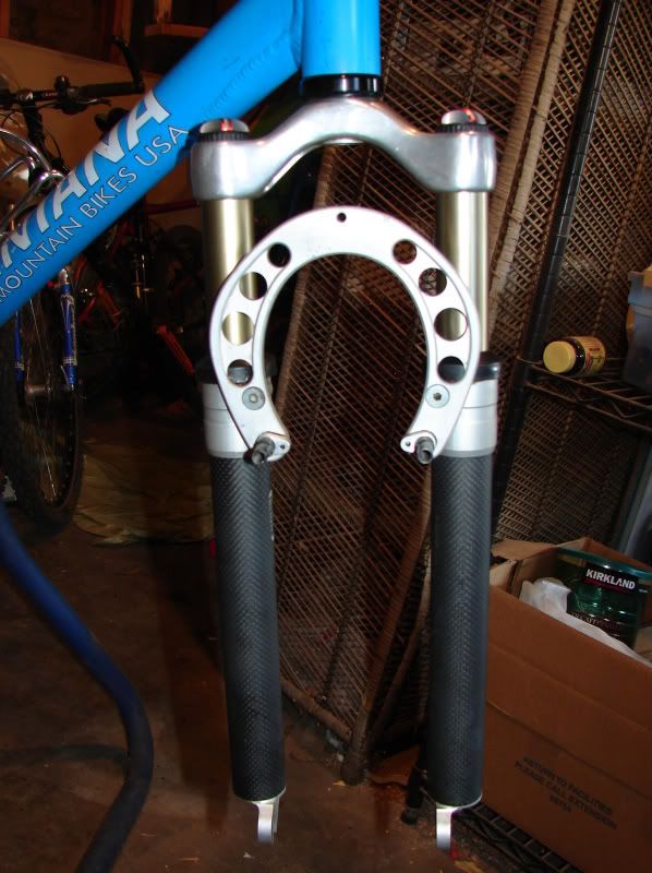

    I ride a 1994 GT Avalanche. Yes, I'm in the market. Back to the Avalanche. At this point, I'm not sure anything is stock except for the frame. A few years back, I finally decided it was time to get a front shock so a friend (old shop guy and gear head) put what he called was a promo carbon fiber-bladed Rock Shox fork that was made around the same time, maybe a bit newer. They were sweet for the era since not a whole lot of carbon was going around back then. But they suck on the trail now because there can't be more than 1.2-2 inches of travel. There are no adjustments to speak of. There are metal screw caps on top of each blade which have a black plastic cylinder. Boot socks. That's about it. My question is whether this thing ever needs any service. The local shop guy says no. I'm wondering if I shouldn't be putting oil or something in them.

    Sounds like you may have an old Rock Shox/Specialized Future Shock FSX
    Does it look like either of these two forks:
    or

    If it is the top one, the easiest upgrade you could do would be to install Englund Total Air cartriges in it. Takes your elastomer stack out and replaces it with air. Very easy upgrade. You take any internal part out and thow it away. Don't know where you can get them anymore, but Speedgoat used to sell them.
    The kit you would want is TA-C-RSJDY72D-A. It is a conversion to a 72mm travel fork. Keep an eye on ebay for one. I had the fork above and it make a world of difference.
