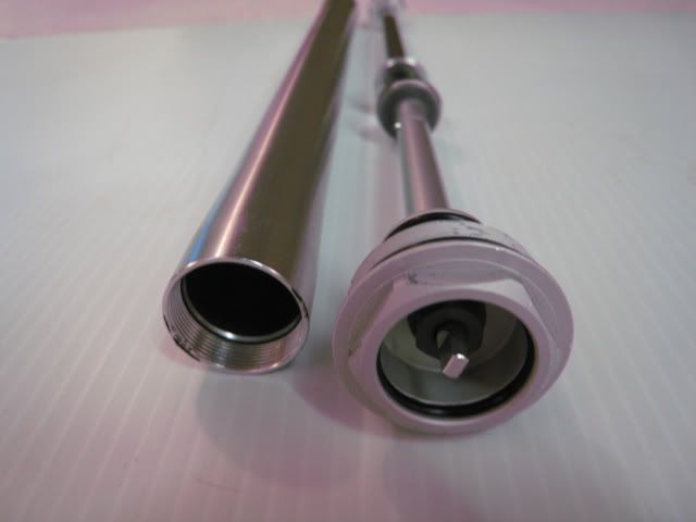

    Thanks for the pictures. Now we have almost the complete description of the TST2.
    One more thing. How is the compression adjusted? is the same type of internal rod, like on the rebound?

    Quote Originally Posted by macadam
    Looks like it works like the ETA to me... An inner shaft inside the main shaft just closing/opening an orifice.

    Hi all - quick question I hope one of you can answer. My 55 TST2 has too much oil in (can't get the last 20mm of travel) and I've been told (by Marzocchi Tech Support on here) to let some oil out. Does this just involve loosening the nut at the bottom of the non-TST side?
  14. #39
    52
    Hi arctic,
    if you want to remove some oil from the TST2 I would open the top cap, the compression unit and remove from there. I would remove the compression unit completely and then measure the oil level such that it matches the length of the compression unit.
    Adrian
  15. #40
    Reputation: arctic303's Avatar
    342
    Thanks macadam. Do you mean the large nut where the TST control is?
  16. #41
    52
    yes, the big top cap. Take a good look at this thread, and pay attention to the pics. Go through all the posts before working on the cartridge, there is great info which might come handy during the service.
    Adrian

    Quote Originally Posted by arctic303
    You need to remove the TST2 cartridge from the fork. Make sure the lock-out is in the open position. Then loosen the nut on the bottom of the cartridge and compress it completely. You can also loosen the top cap. Do this with either open side up. When you compress it and comes out it is over filled. You can then reextend it and retighten the endcap and reinstall it in the fork with 30cc's of oil in the stanchion for lubrication. Make sure everything is tight. Game on.
    Ride Your Bike!
  19. #44
    746
    I have played with different fluid levels and here are couple of things to really watch for:
    First you must not over fill or you can't get full travel, that is where you are now...
    Second, to little oil and you will not have any compression dampening...
    Look back at the cutaway I posted a few days ago, you will see the minimum oil level. If you put just the minimum amount of oil in the cartridge with the rebound rod extended (all the way out) then when you push the rod into the cartridge you will displace a larger amount of oil then one would expect: the rod itself will displaces 30mm or fluid... this is not a misprint! 30mm or oil...
    So you want minimum oil levels to start with other wise it's becomes an airspring with compressed.
    Start with removing the top cap of the cartridge... there is no need to remove the bottom. The reason for removing the top is that the top (compression) piston is fixed and you can't cycle the piston which you will need to do... cycling the piston on the bottom will insure you don't have air trapped underneath...
    With the top cap and compression piston removed fill the cartridge nearly full and cycle the lower piston up and down to insure there is no air trapped below the piston. Now set the oil level @ 110 mm below the top rim of the cartridge. This will allow you 2mm of oil above the compression piston once the top cap is re-installed. Reinstall the top cap... done.
    Once you have the top cap tight you should be able to cycle the rod in and out with ease, there may be just a little resistance when the rod is fully inserted... just enough that the rod may try to extend on it own, an 1inch or so...
