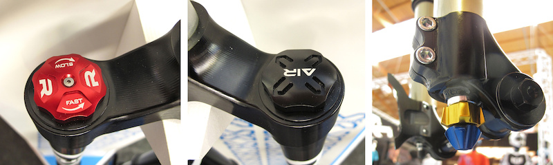

    If it becomes available, I will be the first in line to buy it. I want to upgrade my Lyrik to a Vengeance anyway, and I have always been a huge USD fork fan. At 155lbs, its a match made in heaven.

    The larger diameter stanchions on motocross bikes allow for extra stiffness. There have been many attempts at inverted mtb forks, but larger riders still complain of flex. If someone makes a stiff USD fork, it would take over.

    I have enough scratches on my fork lowers that I wouldn't want my delicate stanchions to be in that area.
    This fork is stiffer than a standard fork in certain ways (front-back motion, for example), but seems much less stiff against the wheel tilting from side to side due to independent leg compressions.

    Assuming this fork ever makes it to production, I would be very surprised if it doesnt come with stanchion guards similar to what comes on the Manitou Dorado or White Brothers Groove. I would think they just kept them out of the picture to give a better look at the fork.
    Its long been said that to make a bicycle USD fork stiff enough(twisting wise), for larger riders and extremely aggressive riders, a larger diameter axle would be required. Manitous 20mm Hex axle is suppose to be the best thing at 20mm, but still suffers from some flex. At this point, nobody wants to make a 25mm axled fork that comes with a hub. They dont feel the market is big enough to have the inconvenience.
