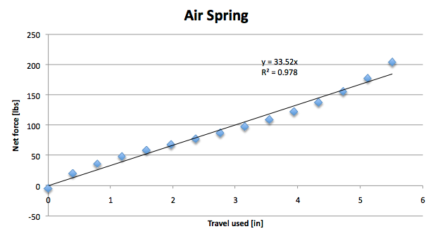

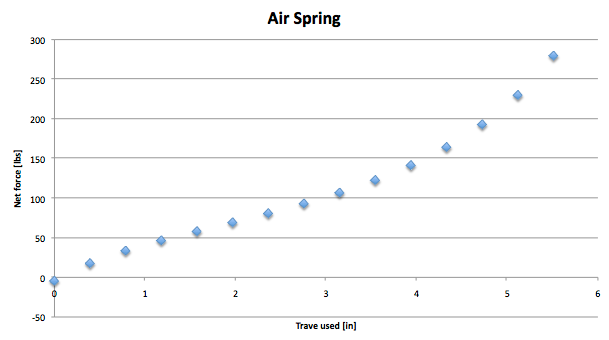

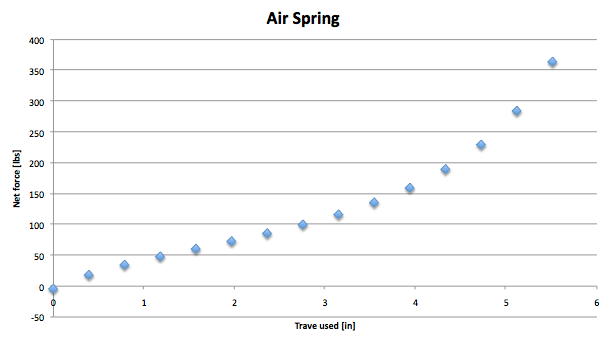

    Air spring force at any given point is the sum of the negative spring force and the positive spring force. Without going into detail, I assure you that it is possible to create a very linear spring curve by manipulating those parameters - this is not to say, however, that items currently on the market actually do this.
    "Initial stiffness"? Please elaborate. I have seen air forks compress over the tiniest of rocks. Also, "more slidng surfaces"? Again, please elaborate.
    Air springs in their usual form (positive spring opposed by negative spring) typically suffer from a "preloaded" feel (caused by a high initial spring RATE - not spring force, spring RATE) that then drops away into low support in the mid stroke, usually followed by a progressive ending stroke (end stroke progression depends almost entirely on positive chamber volume vs piston displacement). Air springs obviously have to have a sealed piston running in a tube at the very least (eg Float forks with the coil negative springs), but normally also have an air negative springs (all air shocks, most air sprung forks) which has a seal head as well, and in some cases even a tertiary sliding seal (eg TALAS, Infinite Travel etc). A coil spring has none of these seals.
    "completely linear sprung suspension needs to be run at a level of stiffness most people would consider unacceptable in order to prevent harsh bottoming out on bikes that are ridden aggressively" I have trouble believing this because motorcycle suspension doesn't use any air at all and has been working in off-road flawlessly for years.
    Motorcycle suspension does however typically rely on progressive leverage rates in the rear end, and spring ramp up in the forks from air chambers that are initially at atmospheric pressure, and whose sizes are dictated by oil levels. Most open bath Marzocchi forks, among others, use exactly the same principles.
    "The "plushest" feeling suspension (not necessarily the most stable or controlled) invariably comes from a system that has a soft spring rate (measured at the wheel) at the start of the travel and a stiffer rate at the end of the travel - in other words, a progressive system." Again, dirt bikes dont have progressive suspension and they seem to have the whole " two wheeled off-road thing" pretty dialed. Coil is the way to go. Plain and simple. The only drawback of coil in a pure performance situation would be weight. And titanium springs will fix that.

  • 11-07-2012
    tacubaya
    As Steve says, you have to consider the net force of an air spring. The positive pressure chamber will generate a resultant force on the air shaft (going downwards) equal to the instantaneous pressure times the piston area and the negative pressure will generate another force but pointing upwards (unless the instantaneous pressure is negative, in that case it goes downwards). Net force is the difference.
    There are SO many parameters one can change on an air spring. Positive and negative pressure, piston diameter, non-compressed volume, initial negative chamber volume etc.
    Here is a 210mm tall air chamber with 150mm of travel, 1.5 cubic inches negative volume, with 65 psi in the positive chamber and 70 psi in the negative chamber, 1.1 inch piston diameter, adiabatic compression of air:
    And after adding 10 cc of oil in the air chamber:
    People doing the air shaft cutting mod were doing the reverse process.
  • 11-07-2012
    beanbag

  • 11-07-2012
    tacubaya
    Originally Posted by beanbag View Post
    yeah, but how linear can you get it?
    Very linear.

  • 11-07-2012
    tacubaya
    His demonstration was not very linear at all.
    Here is the same air spring system, but with a little bit smaller initial negative chamber volume and larger positive air chamber.
    I'd say it is pretty linear, don't you think?
  • 11-07-2012
    beanbag
    Did you use PV=const, or P(V^1.4)=Const?
    Plot the derivative (spring rate), and we'll see.

    tacubaya
    You have an interesting way of taking the derivative where a force can increase 50 lbs in .8 inches, yet the rate is less than 50. And where the force takes 2 inches to make 50 lbs yet the rate is above 25.
    Steve: That is totally cheating LOL where you are taking only the small portion of a ridiculously large air chamber that won't fit in a fork. At least Tacubaya is using realistic volumes and still getting >2x variation in spring rate.
    Yea that image was the first one I uploaded, which I immediately noticed was incorrect. It was replaced with the correct graph but photobucket is updating their system so I guess it will take a while for the image to update.
    As Steve says, do not concentrate on the linearity of the springs, concentrate on what spring rate fits your terrain and riding style best.
