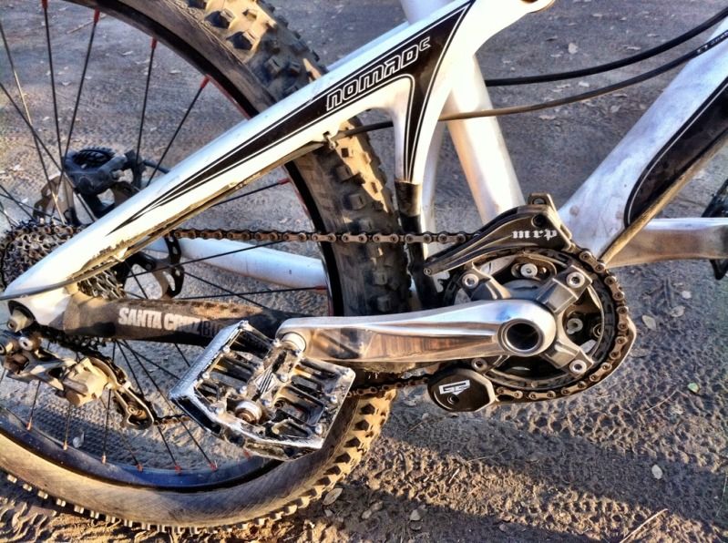

    Running 2x10 with "a 36 tooth ring" and a short cage is actually possible. This is what road bikes do. But road cassettes aren't bigger that 28T, and there is less difference in most road cranksets between the small and big rings. The absolute size of the ring does not matter to the derailleur, as sizing the chain compensates for this. What matter to the RD is the range of teeth that it has to take up chain slack for, and the size of biggest cog on the cassette, so the upper pulley can clear the cog and not crash into it.

    r1Gel
    Converted my SS to 1x10 in May2013 but never got around to posting anything about it.
    I started commuting to work and the SS was just too hard on my body.
    Apart from a minor adjustment after the first real ride, the Zee RD has been working flawlessly so far. Got iSpec SLX shifters and a SLX 11-36t cassette to go with it. I'm gearing down to a 32t RaceFace Narrow-Wide up front (currently on a Blackspire Mono Veloce 34t) and ditching the bashwich, but the RF still out of stock where I ordered it from. 'hoping it'll get to me by next month.
