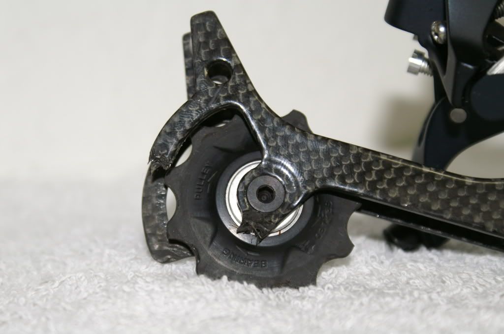

    XTR Shadow carbon cage cracked! replaceable? Where do I find it? w/pics
    As the title says... My XTR Shadow cage cracked with a branch my wheel picked up. (Thank god it was the day after a 12hr race!) I've only had it for about 1.5 months. so ya... is the carbon cage replaceable? I know I could change it, but where would I find just this piece? (Just need the outer carbon cage face)
    pics showing damage... and what I need...
    close up...
    and yes, the minor damage causes it to malfunction... big time...

    I think the cage is replaceable, but it's going to be expensive.
    offroader
    Dec 2008
    2,190
    http://www.chainreactioncycles.com/M...?ModelID=35059
    http://www.shimano-yumeya.com/
    Why no contact shimano and see what spare parts they have. I'm sure your LBS can order spares as well.

    Ah found something:
    Shimano Spares - RD-M972 outer plate SGS
    http://www.petracycles.co.uk/product...ource=googleus

    thanks so much! I did some research for a while, and apparently I suck at it....

    I wonder if the SG Saint shadow cages is the same size as the XTR shadow SG cage. The Saint aluminum cages looks like it will work in the XTR but I dont know if they are the same size.

    I know it's late, but I hope it will be useful to other persons who have the same problem you and I had. When I told my LBS that I had broken the bottom part of my XTR Shadow cage, we checked with the Shimano distributor, just to learn that the outer cage was as expensive as the whole derailleur itself. So, my trusted buddy mechanic working there (his name is Dominique and he's worth a little tribute) patented me something with an old Shimano (XTR ?) derailleur cage that works wonder. Here is what it looks like :

    Mine broke some time ago and the replacement plate (one side) is about $40. I got an XT shadow for $80 instead. I can't think of a worse place to put carbon on a mountain bike.

    Mine cracked 2 weeks ago during the 1st day of the E-Fix, a 3+ day adventure race which included 200mi of riding with LOTS of climbing. It was a pain to ride. It's the plate closest to the wheel that's cracked. The bike shop wants $120 for one plate from Shimano. Chain Reaction is out of stock, Fair wheel bikes has for 971 not 972, anyone know of another option? I could care less if it's carbon or not. Thanks!
    My tire picked up a small twigg, really small just 10cm that got jamed between my spokes and deraillur. It cracked the inner carbon cage and put a small dent in one spoke. Guess it is something that you have to live with. Unfortunately the m992 was just 3month old but I order the xt shadow for 25% of the price and will keep the xtr as a spare part. I hope the xt cage and xtr cage are interchangeable. Is there any other differance between xt and xtr besides the carbon cage?

    I had the same thing happen, I called shimano and they confirmed the XT M772 cages will work on the XTR. part numbers are: Y5W710000 and Y5W798050
    I'm going to try them out and report back.

    I'm going to avoid ranting about the stupidity of using carbon fibre here - or maybe the stupidity of buying carbon fibre here
    Any word on whether these worked? I think the Y5W798050 is the RD-M772 and that that is the outer cage, which unsurprisingly is the one that I broke. Where did you buy them? Are they for the long cage?
    thanks
    6
    Just to say that nowadays XT shadows M772 plates are not compatible as is with XTR. The fixation system is not the same at all

    i have had the same problem twice now , the warranty sorted it out the first time but the second time i found this site .fibre-lyte.co.uk, this guy is awsome he is even building me a outer cage too
    Just a quick post for those who want to know, we (fibre-lyte) now manufacture replacement inner and outer cages for the M972 derailleur. The inners are shown on our website, the outers aren't shown yet but will be soon. Please be aware that we don't include the alloy inserts (barrel or spring limit screw) in the outer cage, these need to be sourced from the original Shimano plate but they're usually still attached when breakages happen.

    I know this is a dead old thread but in case someone out there dusts off their old 9 speed M972 xtr der w/ the broken cage and is looking to get it going again for that spare bike, the cage (GS only!) from the Saint (inner and outer - the whole thing) M810 and M810A will fit according to the shim tech docs. These are still avail online (mostly in europe).
    ie: http://techdocs.shimano.com/media/te...9830799958.pdf
