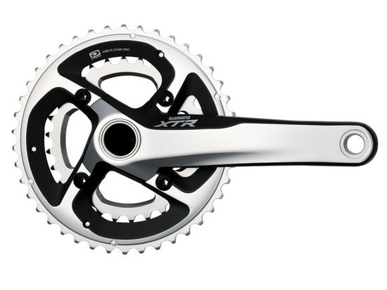

    Quote Originally Posted by COLINx86
    I don't think so, definitely a similar crank, but it's not the same.
    I went back and actually re-read the review that I was thinking of when I made my post. Turns out we're both right. Sorry about that. Your pictures show the triple and the narrow Q-factor XC double. I was referring to what Shimano is calling the "trail" double crank.
    Quoted from Here: http://singletrack.competitor.com/20...imano-xtr_9617
    There are three crank options, each offered in 170, 172.5, 175, or 180mm lengths:
    • The mainstay 42-32-24 triple
    • Two narrow Q-factor XC doubles (with either 42-30 or 40-28 chainrings),
    • A “trail” double crank (38-26 tooth chainrings mounted on the inner and middle positions of a normal, wider Q-factor triple crank, so it can accommodate a chainring guard or even convert back to a standard triple)
